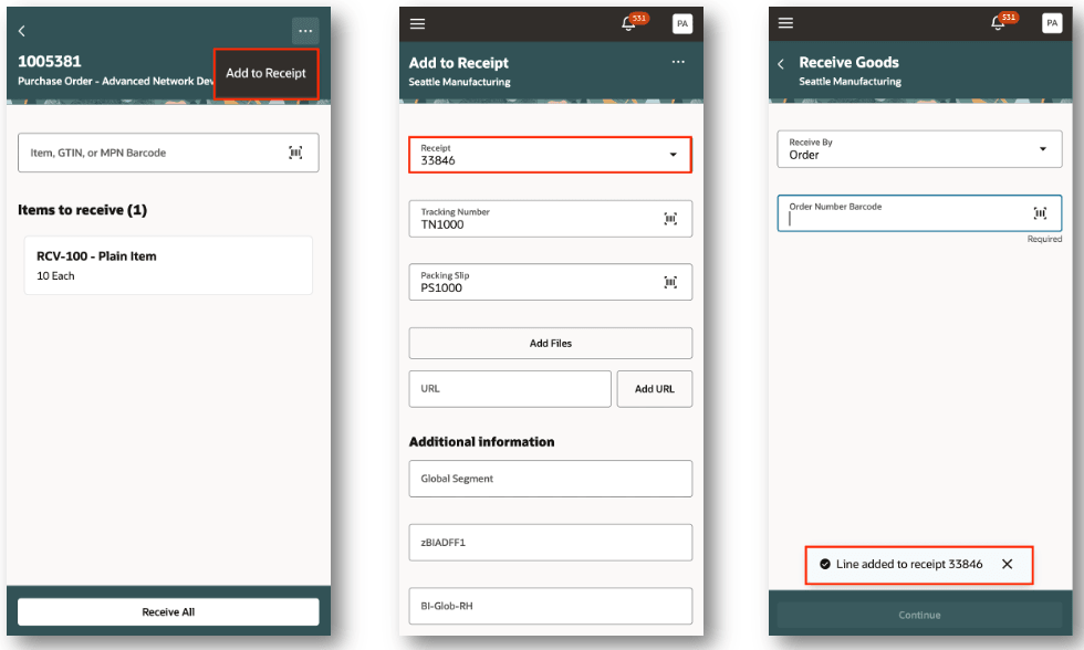

Now, you can add new receipt lines to an existing receipt in real-time when using a mobile device.
A new Add to Receipt action has been introduced for you to select an existing receipt to add to. After you click Add to Receipt, you will have a list of existing receipts to choose from. The Tracking Number and Packing Slip values will be automatically set to default. After you enter the receipt details and submit the receipt for processing, a toast message appears confirming that the line has been added to an existing receipt.
Add to Receipt
Add to Receipt
This feature ensures you can comply with internal policies while maintaining faster processing of large orders, improved coordination across receivers, and more accurate, complete receipt records.
