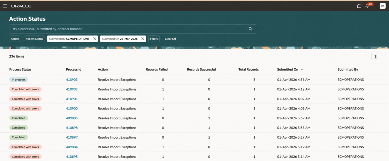

  4. The process status is shown as in progress if the agent is currently processing. Post processing if the orders were successful imported, the process status would be completed or completed with errors.
This example shows process status types, including actions in progress.

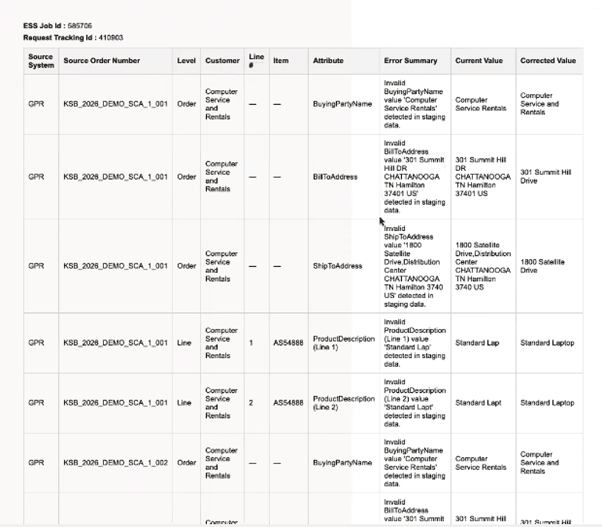

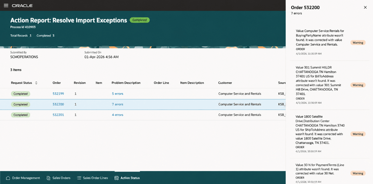

  1. Click the Process ID to see the error details. The order number is displayed along with the corrected errors. The customer name error is corrected by the agent using the customer master value of Computer Service and Rentals.
In this example, the warnings are also displayed on the order that was imported and are cleared on submit.
Action report showing the customer name corrected by the agent.

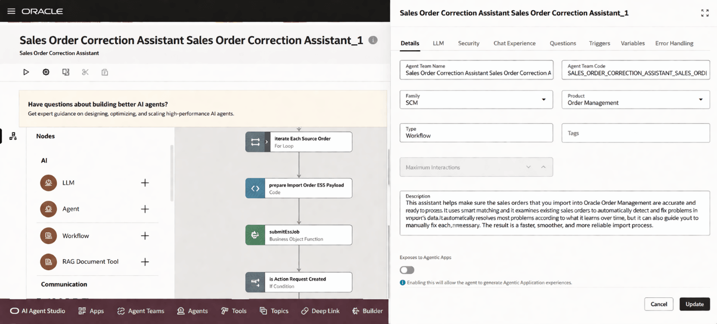

  2. Go to Home > Tools > AI Agent Studio, then search for Sales Order Correction Assistant.
  3. Click Actions > Copy Template, enter a suffix, then click Continue. We recommend that you use the suffix to indicate versions, such as 1, 2, 3. For this example, assume you enter 1 for the suffix.
  4. Click Publish, then confirm that the agent's status is Published.
  5. Click Agent Teams, then query for Sales Order Correction Assistant 1.
  6. Copy the value that's in the Agent Team Code attribute. For this example, assume it's SALESORDERCORRECTIONASSISTANT_1.
  7. To schedule the agent – select Settings icon
This is an example of the details drawer for the correction assistant agent. Notice the tabs for the various agent detail options.
Sales order correction assistant AI agent example
