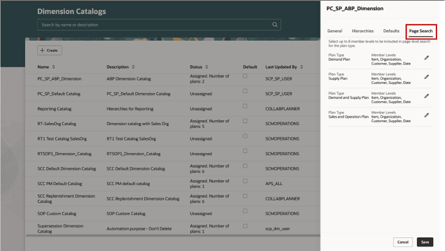

3. On the Dimension Catalogs page, select Edit.
Navigating to page search
4. Select the Page Search tab.
Page search tab
Page search tab
