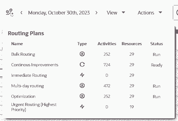

Screenshot displaying the routing plans report.
