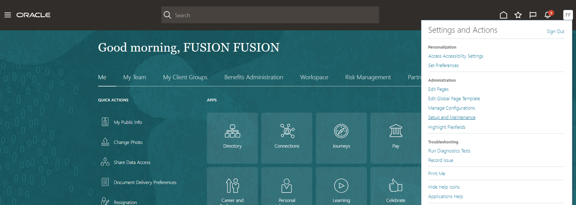

  1. Login as Fusion to any environment

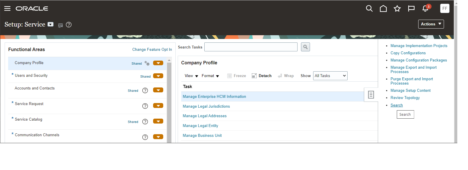

  2. Go to Setup and Maintenance
  1. Click on Search
Search task

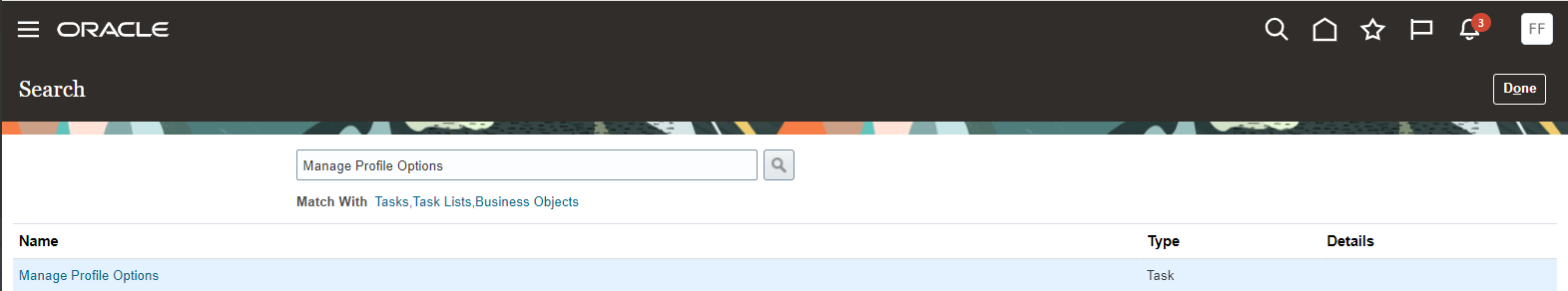

  1. Search for "Manage Profile Options" and click on it
Search for Manage Profile Options

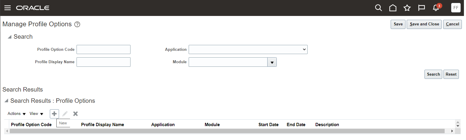

  1. Click on "+" under Search Results: Profile Options
Add new record
Add new record

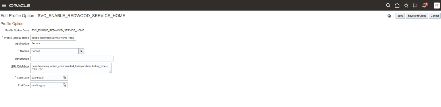

  1. Create Profile Option with below values and Save
Create New Profile Option with Values
Column
Values
Profile Option Code SVC_ENABLE_REDWOOD_SERVICE_HOME
Profile Display Name Enable Redwood Service Home Page
Application Service
Module Service
Description Enable Redwood Service Home Page
SQL Validation Select meaning, lookup_code from fusion.fnd_lookups where lookup_type = 'YES_NO'
Start Date 03/04/2024

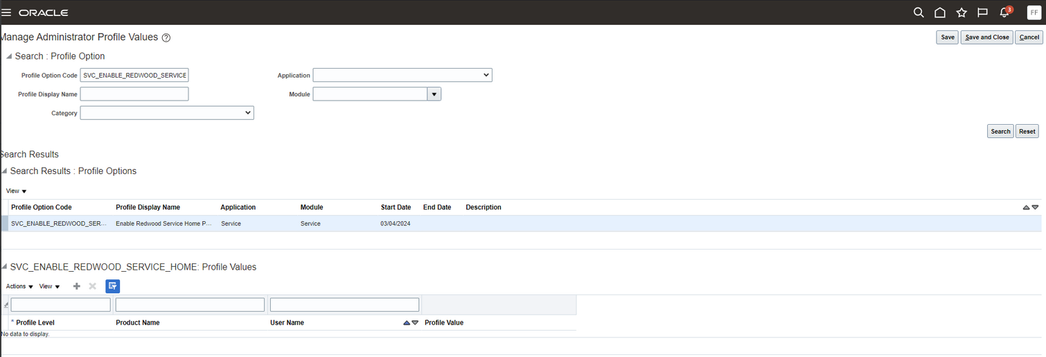

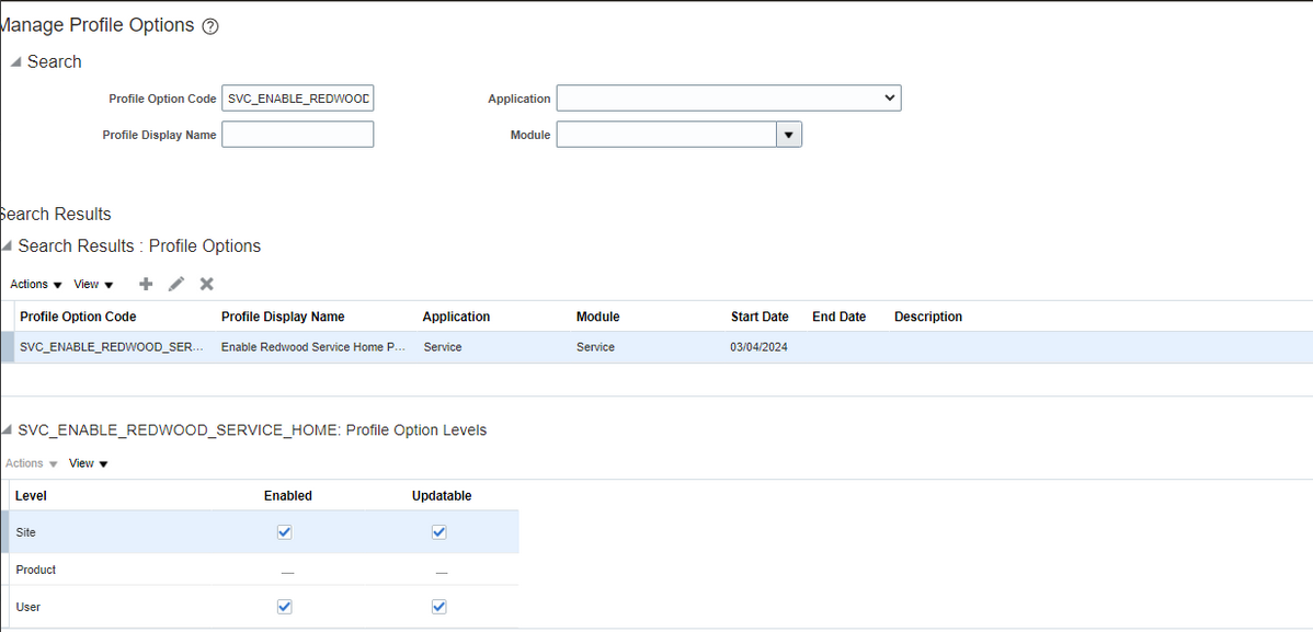

  1. Set Profile Option Values to Site and User as below and Save and Close

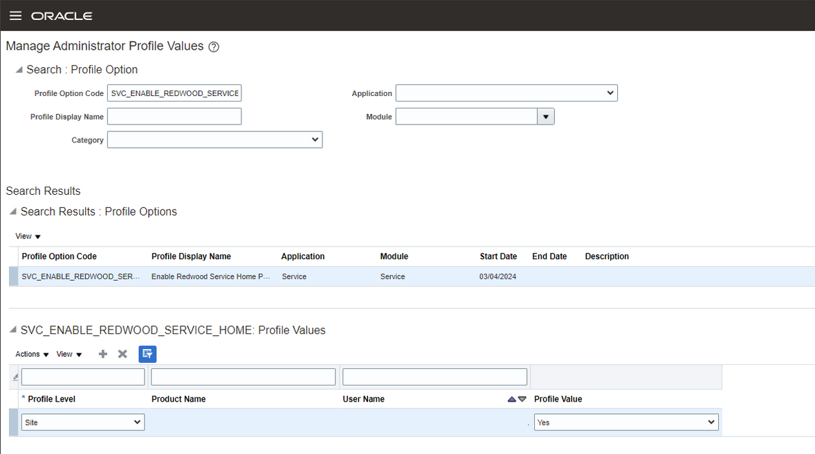

  1. Now go to Manage Administrator Profile Values and enter Profile option code as SVC_ENABLE_REDWOOD_SERVICE_HOME and click on Search
Manage
Manage Administrator Profile Options
  1. Click on "+" under SVC_ENABLE_REDWOOD_SERVICE_HOME: Profile Values which will create a new empty row. Select either "Site" or "User" and set the profile value to "Yes" and click Save and Close
site value
Set Site value to Yes

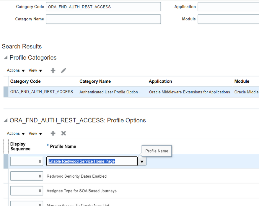

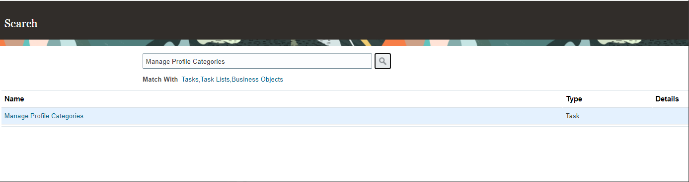

  1. Now add this new profile option to one of the secure categories (ORA_FND_AUTH_REST_ACCESS) to give it AUTH access so it can be retrieved via REST endpoint
Add New Profile Option
Manage Profile Categories

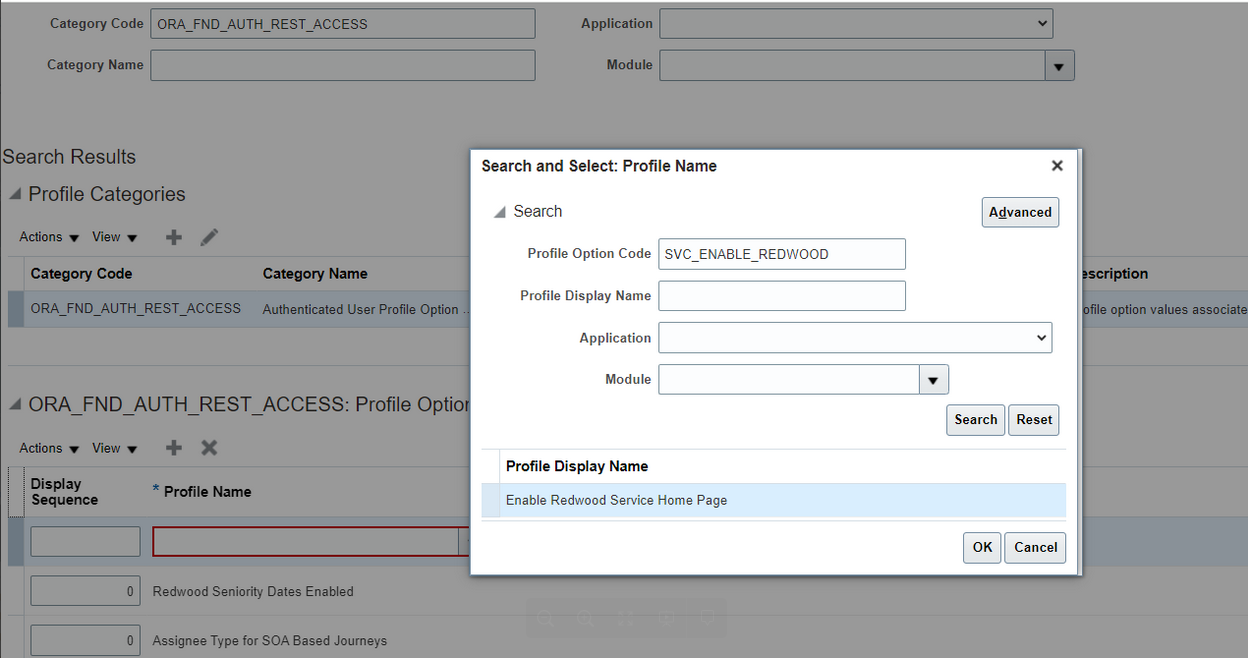

  1. Search for "ORA_FND_AUTH_REST_ACCESS" and click on "+" under ORA_FND_AUTH_REST_ACCESS: Profile Options. Search for the new profile option and select.
Search
Search for ORA_FND_AUTH_REST_ACCESS
more
  1. Finally, hit save and close. This profile option should now be ready to use.
