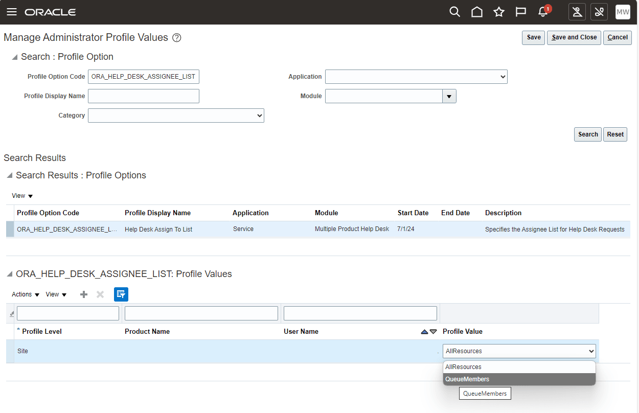

To limit the AssignTo field options to only included members of the queue:
  1. Go to Setup and Maintenance.
  2. Click on the Task icon.
  3. Click Search.
  4. Search for Manage Administrator Profile Values.
  5. Click on the link to the task Manage Administrator Profile Values.
  6. Enter ORA_HELP_DESK_ASSIGNEE_LIST in the Profile Option Code.
  7. Click Search.
  8. Change the Profile Value to QueueMembers, as shown below.
Limit AssignTo to QueueMembers
