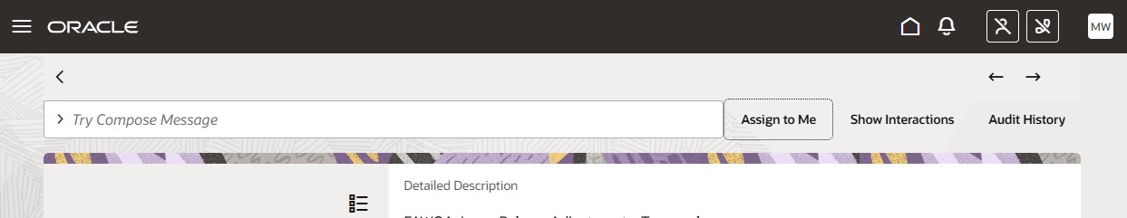

The new Button Bar on the Help Desk Request Detail page enables Help Desk Agents with easy one-click access to common SmartActions like Assign to Me, Create Appointment, or Compose Internal Note. In the extensible button bar area, administrators can configure any number of new or additional SmartAction buttons to meet the Help Desk team's needs.
Button Bar
Button Bar
The Button Bar reduces the think=time and clicks required by a Help Desk Agent, by clearly displaying frequent actions on the Help Desk Details page. This enhances the user experience in three ways:
  • More Discoverable - Makes it easier to learn and understand what to do and how to do it
  • Easier Repetition - Take advantage of "muscle memory" to quickly perform actions because buttons are always in the same place
  • Better Productivity - one-click for the most common actions
