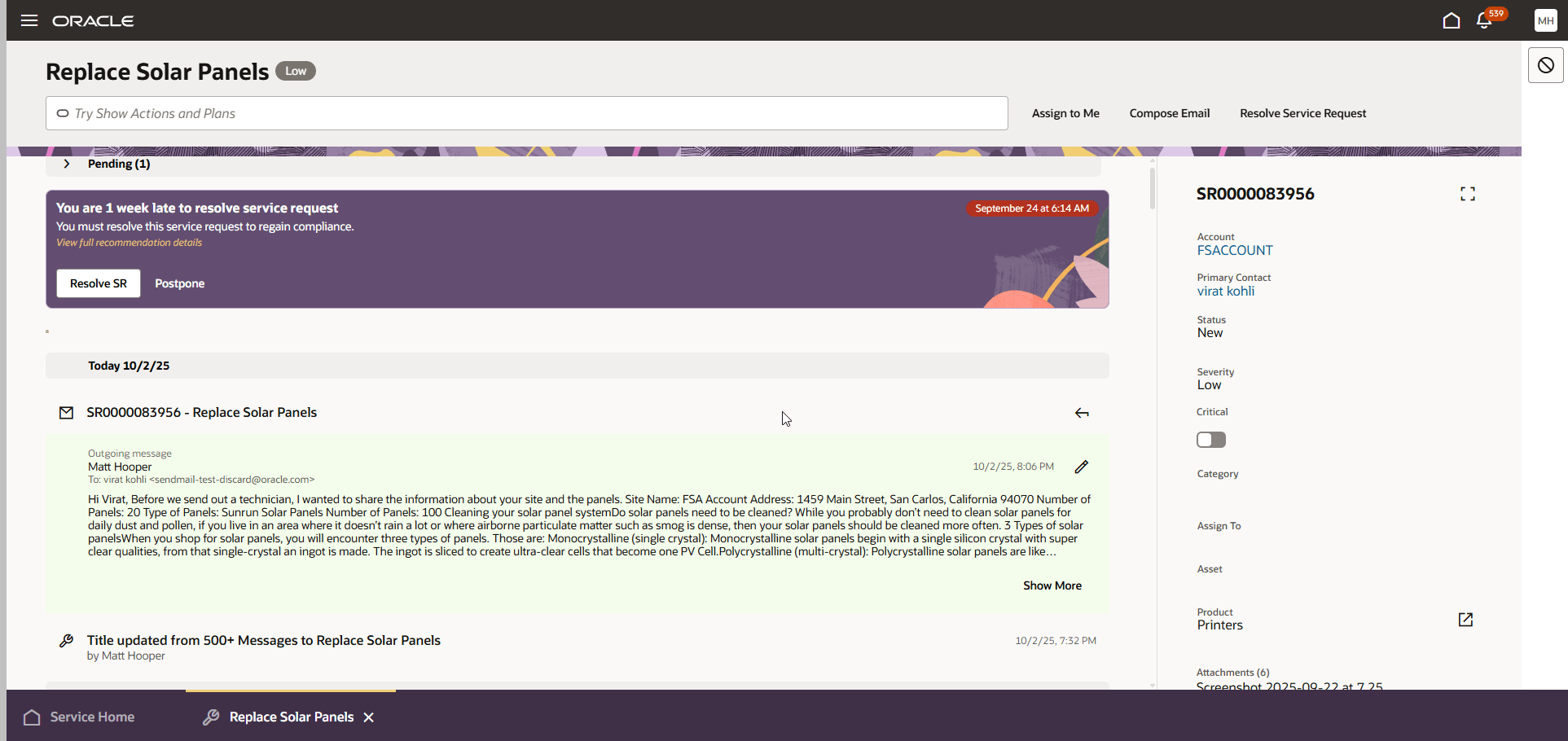

Here is what the service request looks like when the Messages are collapsed.
SR Message Collapsed
SR Messages Collapsed

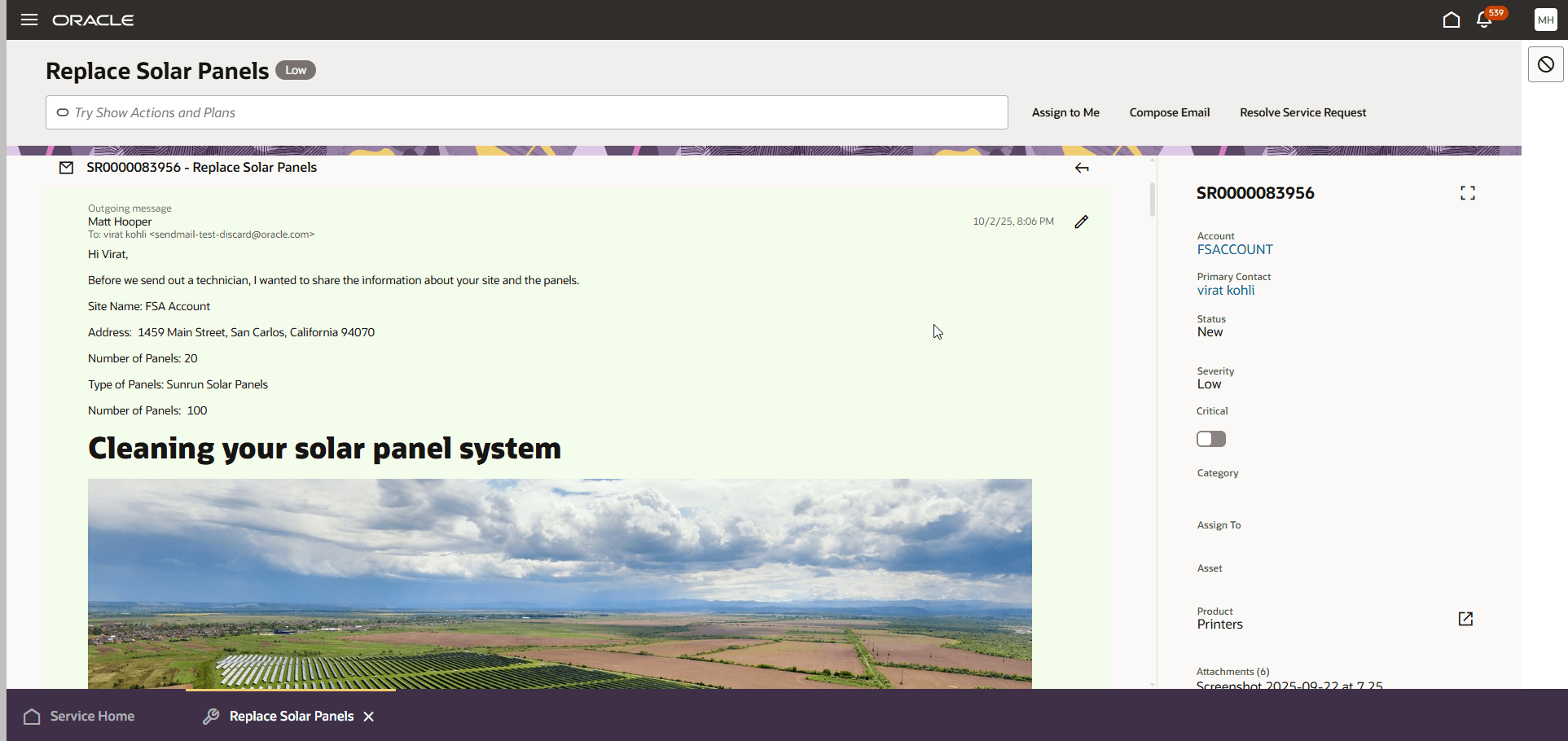

Here is the same service request after the profile option is set to Yes and expanded by default.
SR Messages Expanded
This feature makes it faster and easier for you to read and review all messages in a service request. It improves productivity by eliminating the need to manually expand each message, helping you resolve issues quicker and deliver better service.

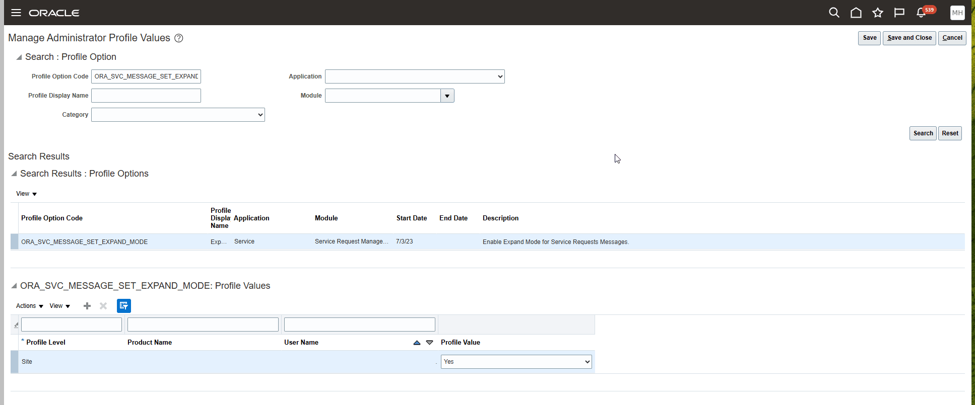

Steps to enable and configure
Follow these instructions to change the profile option. You must be logged in with an administrator role.
  1. Navigate to the Setup and Maintenance area in your application.
  2. Search for and select the Manage Administrator Profile Values task.
  3. Search for the profile option code: ORA_SVC_MESSAGE_SET_EXPAND_MODE.
  4. Set the value to Yes.
  5. Save your changes.
Set Profile Option
Set Profile Option
After enabling this option, all messages in the SR Details page will be automatically expanded for easier review.
