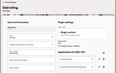

Steps to enable and configure
  • Make sure you have configured an OAuth Application from the Configuration > Applications > Add Application page with OAuth User Assertion.
  • Make sure you selected this application from within the Debriefing plugin.
Configure page
Configure page
  • There is no additional setup configuration required to work the Debriefing plugin.
