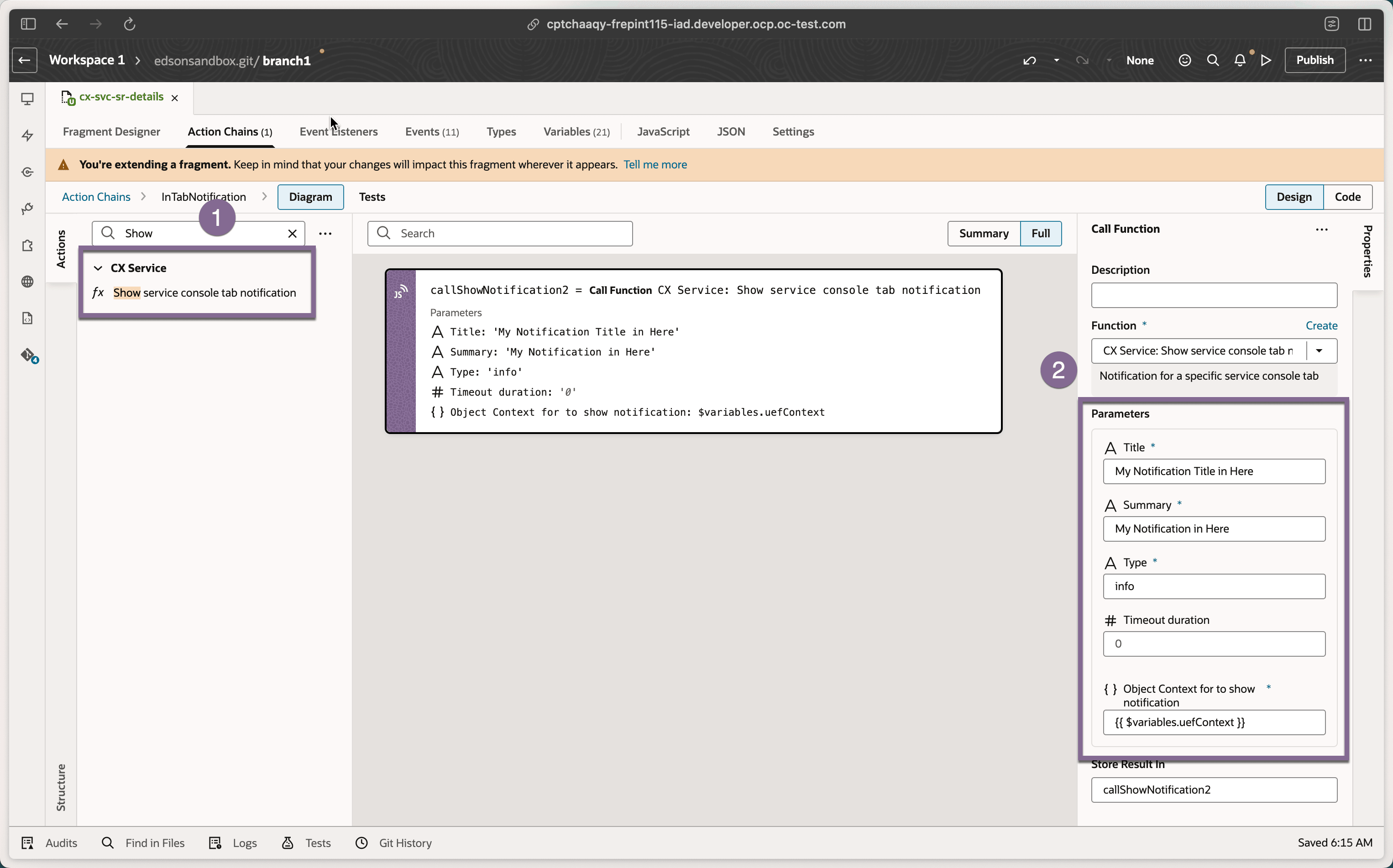

Show Notification In-Tab CX Service Action
Steps to Enable
  • Open Visual Builder Studio within Oracle Fusion Service Console.
  • Navigate to the relevant Action Chain where you use the Notification action.
  • Replace or extend the existing notification step with the new Show service console tab notification provided in the CX Service action group
  • Map the function to fire on the active tab context only.
  • Test across multiple open tabs to validate tab isolation behavior.
Note:  Use $base.variables.uefContext for UEF Context.
