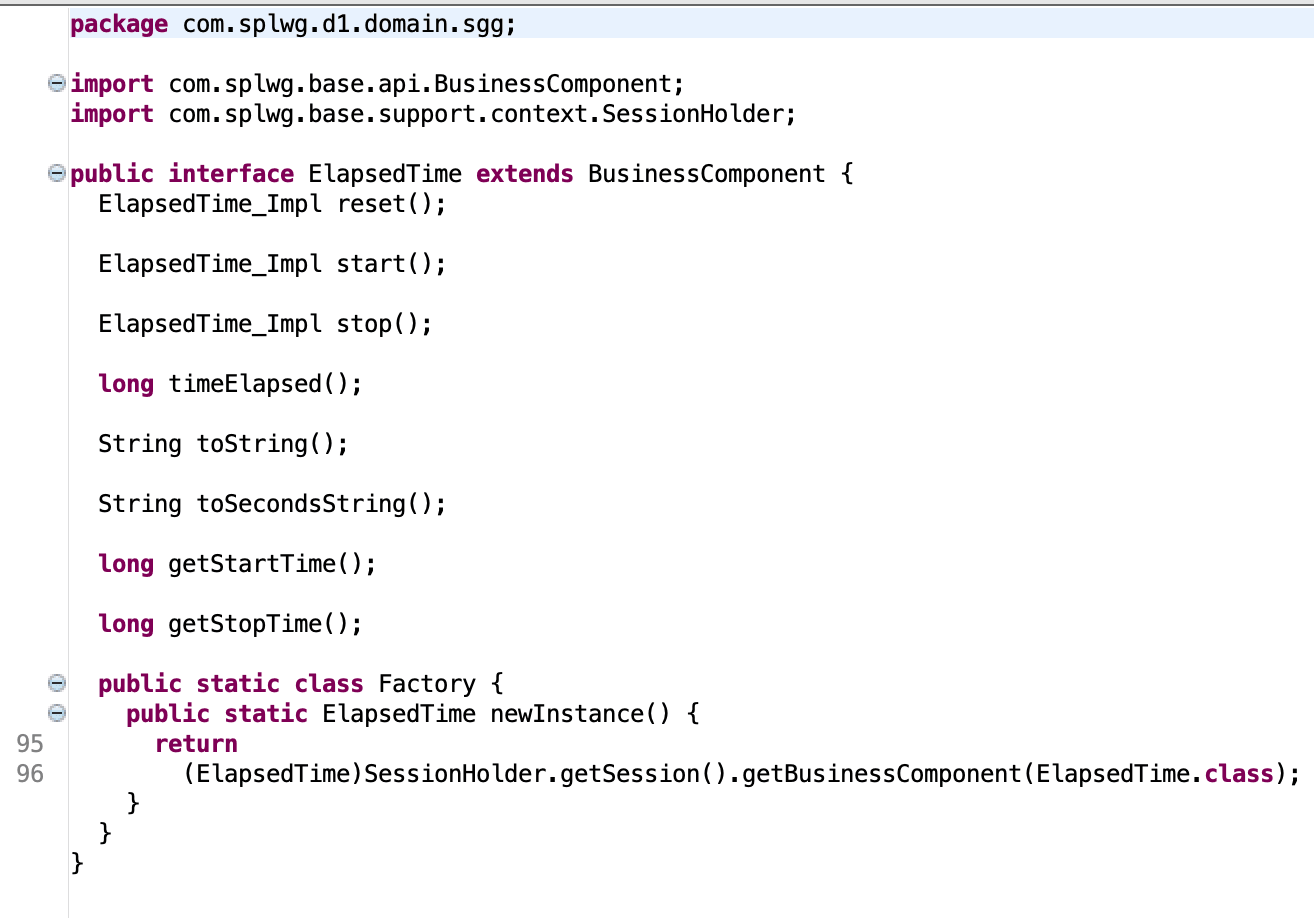

Error 2
Issues related to component definition not found (example, com.splwg.shared.common.LoggedException: Did not find a component definition for business component class class com.splwg.d1.domain.sgg.ElaspedTime_Impl).
Cause
Groovy uses the type of the object that is assigned to the variable as its inferred type.
In this example, the methods of ElapsedTime component (start, stop) has return type of ElapsedTime_Impl and the inferred type that comes out is ElaspedTime_Impl and not ElapsedTime.
timer = SGGElapsedTime.Factory.newInstance().start()
Tye of Object Assigned Used as Inferred Type
Type of Object Assigned Used as Inferred Type
Solution A
Update the class and use ElapsedTime as the return type of its method (start, stop, reset).
timer = (SGGElapsedTime) SGGElapsedTime.Factory.newInstance().start.()
Solution B
Typecast the return type of the methods to ElapsedTime.
timer = SGGElapsedTime.Factory.newInstance().start() as SGGElapsedTime

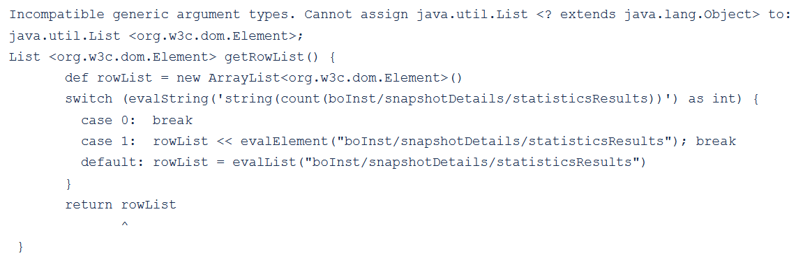

Error 4
Incompatible Generic Argument Types
Cause
Incompatible types, for example: rowList = evalList("boInst/snapshotDetails/statisticsResults").
Solution
Typecast the List to be of Element type and assign it to rowList variable.
rowList = evalList("boInst/snapshotDetails/statisticsResults") as List<org.w3c.dom.Element>
