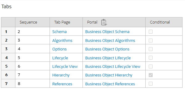

When a tab portal is configured with a visibility option, the Tabs zone on the related Main (standalone) portal will indicate that the tab is conditional.
Tabs Zone
Tabs Zone
