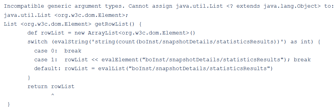

Error 4
Incompatible Generic Argument Types
Cause
Incompatible types, for example: rowList = evalList("boInst/snapshotDetails/statisticsResults").
Solution
Typecast the List to be of Element type and assign it to rowList variable.
rowList = evalList("boInst/snapshotDetails/statisticsResults") as List<org.w3c.dom.Element>
