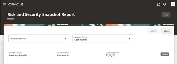

Click the Add button in the Risk and Security Snapshot Report page. Two fields appear above the records of any analyses you've already run.
In the Business Process field, select the business process for which you want to evaluate risk: Accounts Payable, General Ledger, Order to Cash, or Human Capital Management. However, you can run only one analysis of each process at a time.
In the Analysis Period field, select the amount of time the analysis is to cover: the week, month, three months, or six months previous to the moment you submit the job. The previous month is the default.
Click the Submit button. A row for the analysis appears in the list of analyses.
