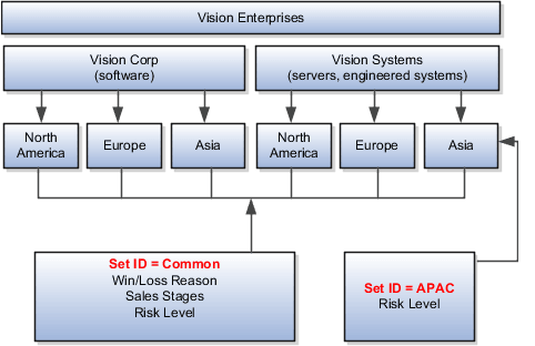

You can create separate sets and subsets for each business unit. Or, you can create more common sets or subsets to enable sharing reference data across several business units, without duplicating the reference data.
This illustration shows an example of reference data in the Common set and different reference data in a set called APAC. Users associated with the BUs assigned to the Common set can access the data associated with it, but they can't access the data associated with the APAC BU, unless they're part of the BUs assigned to that reference data.
The diagram shows Vision Enterprises as encompassing its two divisions, Vision Corp. and Vision Systems. The diagram shows the two divisions, Vision Corp. and Vision Systems, as each encompassing three BUs: North America, Europe, and Asia Pacific. The diagram also shows a Common set and an APAC set, each containing different reference data.
