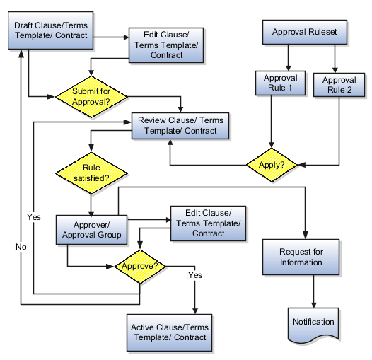

The approval process is the same for a supplier contract and a customer contract. So, when you submit a clause, terms template, or contract for approval in Procurement or in Sales, the contract approval process starts, which in turn starts a set of approval rules created in AMX to build the list of approvers. AMX then sends out approval notifications to the first set of approvers and then again to the next set of approvers in the approval list every time it receives a response to an approval notification. This process is repeated until all approvals are complete.
This figure shows how each approval rule is applied in turn to the clause, terms template, or contract, and how at least one must be satisfied for the clause, terms template or contract to be approved and activated:

The approval process is:
- When the contract, clause, or terms template is submitted, based on whether it
            satisfies the task payload attributes of the approval rule and its conditions, it's
            routed to the approver or approval group specified in the approval rule. The approver or
            majority of approvers in the group can then do any of the following:- Approve the contract, clause, or terms template as is
- A link for viewing the contract is included in contract notifications by default. However, the link can be hidden using personalization
- Reject the contract, clause, or terms template
 If approved and the contract, clause, or terms template satisfies other approval rule attributes and conditions, the approval process continues. If rejected, the approval process ends.
- If the contract, clause, or terms template doesn't satisfy any further approval rules, based on the last approval rule result, the approval process either ends or the contract, clause, or terms template is activated.
AMX configuration options for Contracts determine most of the actions that are available to the participants in the approval process. For example, as an approver:
- You can reject the contract, clause, or terms template. - By default, the approval process stops when the contract, clause, or terms template is rejected and the contract, clause, or terms template returns to draft status for further editing and resubmission.
- By default, the next approver or approval group of the next applicable approval rule is notified when you approve the contract, clause, or terms template.
- You can also request more information from the other approver, the person who submits for approval, or both. Such requests don't affect control of the approval process, but the person from whom information is requested receives a worklist notification.
- You can't edit a contract in pending approval status. You can enter comments in the Notification Task Details page and reject it, so that the approval requester can edit it.
- You can perform ad hoc insertion of approvers.
- You can delegate your approval responsibilities to other approvers.
- You can claim the approval and respond. By default, the approval process stops at the first response and the response of the first approver that responds becomes the response for the approval group.
If you change the default settings of the AMX configuration options, then different actions or action outcomes become available to this approval flow.
