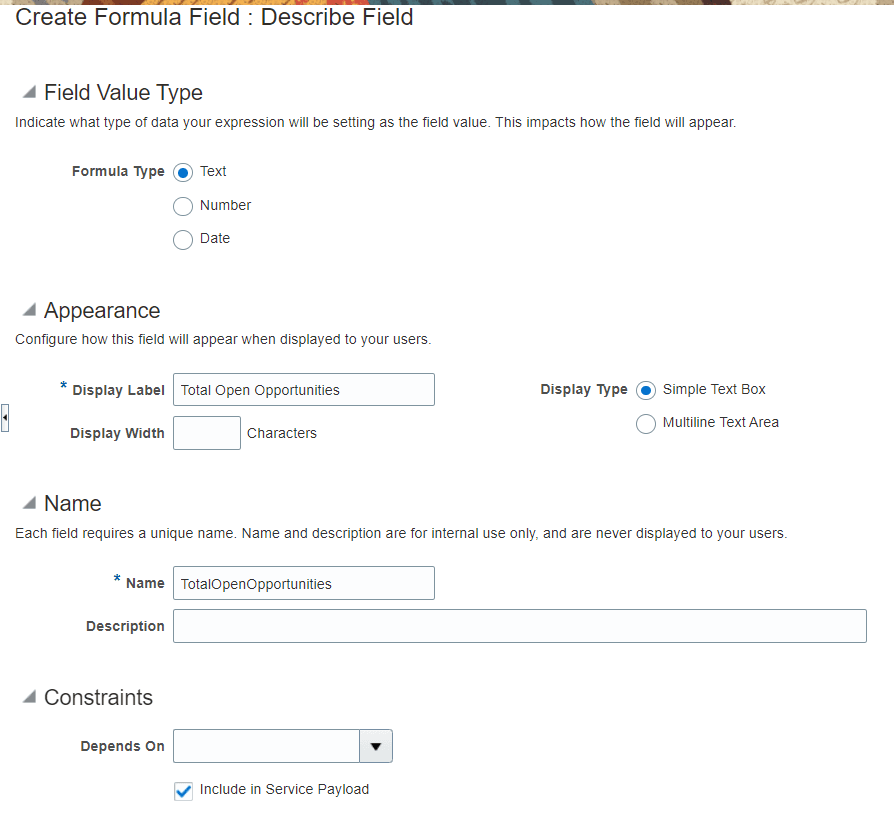

- Create a formula field for Total Open Opportunities:
- On the Create Formula Field page, enter
for Display Label, and enter the same name, but without spaces, in the Name field.
Here's a sample image of the Create Formula Field page:
- Click Next.

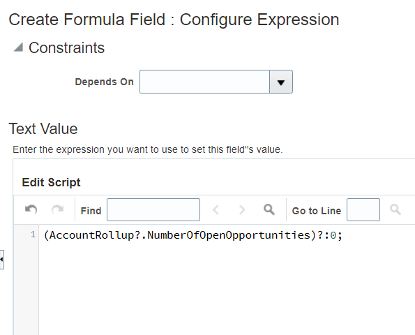

- On the Configure Expression page, enter an expression the engine should
consider when calculating the field value. For example, use this expression
to indicate that the engine must not calculate when the number of
opportunities for an account is
zero:
(AccountRollup?.NumberOfOpenOpportunities)?:0;
Here's a sample image of the example expression:

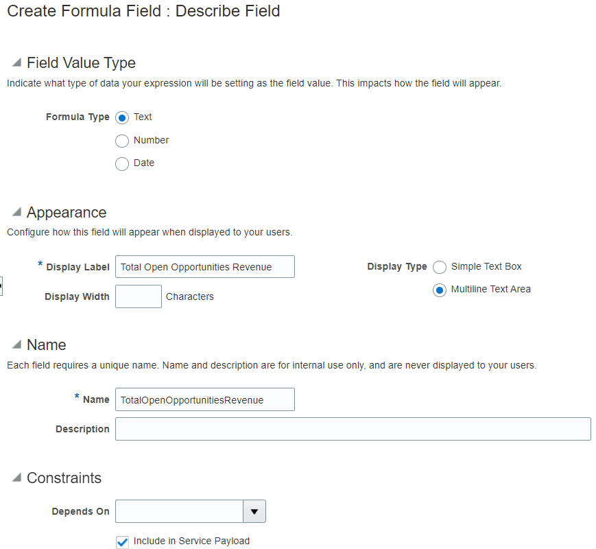

- Create a formula field for the Total Open Opportunities Revenue rollup:
- Follow the procedures given in steps 2 and 3.
for Display Label, and enter the same name, without spaces, in the Name field. - For Display Type, select Multiline Text
Area.
The formula field appears as a multiline text area to display two rollup fields. In this example, the two rollup fields are
SumOfOpenOpportunitiesRevenue
andHierSumOfOpenOpportunitiesRevenue
-- one for the account and another for its hierarchy.Here's a sample image of the Create Formula Field: Describe Field page:

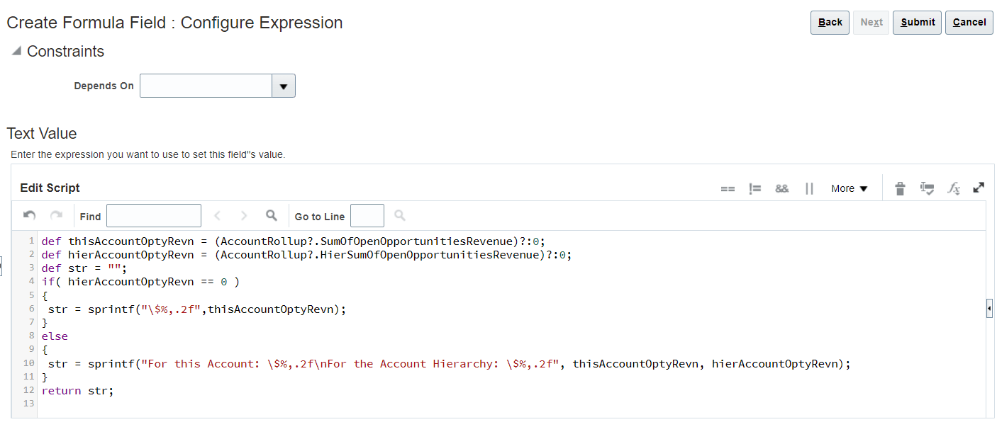

- On the Configure Expression page, do this:
- In the expression for the formula field, create a variable to store
the sum of opportunity revenues for an account. Create another
variable to store the sum of opportunity revenues from an account
hierarchy. In this example, the variables are
thisAccountOptyRevn
andhierAccountOptyRevn
. - Ensure that the expression evaluates whether the value of the opportunity revenue is zero. If it is zero, set the variable to null. Also, evaluate whether the value of the opportunity revenue from an account hierarchy is zero. If it's zero, don’t display the account hierarchy rollup.
- To write the expression, select the field from the list
corresponding to the Rollup object. In this case, Account Rollups is
a child of Account, and it has a 1:1 relationship with the Account
object. Once you select the Account Rollup, the Rollup fields appear
on the list. You can reference the fields easily and insert them to
the script palette to write the expression. In this case, use the
fields
AccountRollup?.SumOfOpenOpportunitiesRevenue
andAccountRollup?.HierSumOfOpenOpportunitiesRevenue
in your expression. These are the custom rollups you created in the previous step.
- Build an expression like the sample
here:
def thisAccountOptyRevn = (AccountRollup?.SumOfOpenOpportunitiesRevenue)?:0; def hierAccountOptyRevn = (AccountRollup?.HierSumOfOpenOpportunitiesRevenue)?:0; def str = ""; if( hierAccountOptyRevn == 0 ) { str = sprintf("\$%,.2f",thisAccountOptyRevn); } else { str = sprintf("For this Account: \$%,.2f\nFor the Account Hierarchy: \$%,.2f", thisAccountOptyRevn, hierAccountOptyRevn); } return str;
Here's a sample image of the Create Formula Field: Configure Expression page:

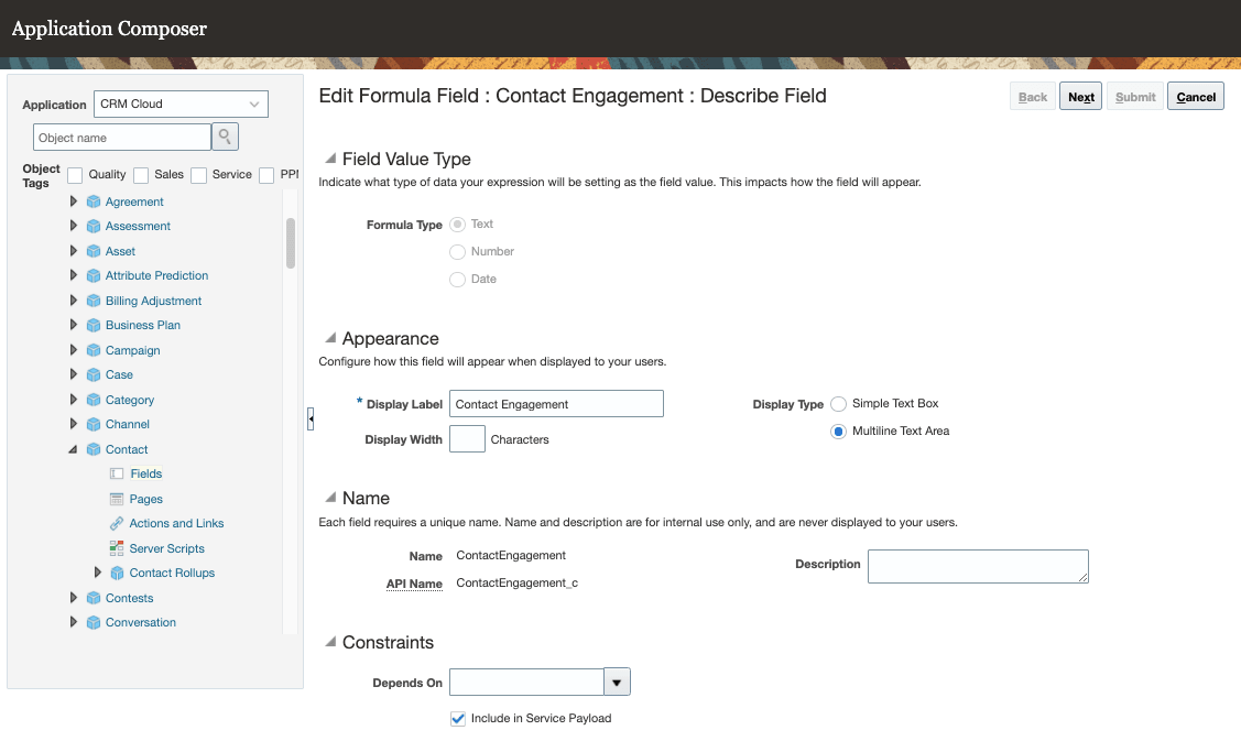

Contact Engagement
for Display Label, and enter the same name, but without spaces, in the Name field. - For Display Type, select Multiline Text Area.
- Click Next.
