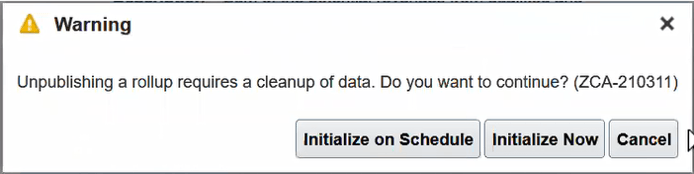

Data Cleanup Process
When you unpublish or delete a rollup, the application prompts you to clear up the data.
  • Select Initialize on Schedule to let the Data Cleanup scheduled process clear the data.
  • Select Initialize Now to initiate the data cleanup immediately.
Warning message shown when unpublishing a rollup.
