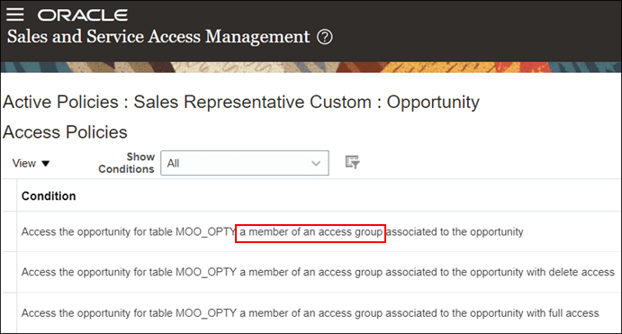

    Don't edit any policy where the Condition name of the policy includes a reference to access group. These policies, shown in the screenshot, are required for users to get access to object data through access groups and must remain associated with the custom role.
    A screenshot showing the data security policies that grant access to access groups.

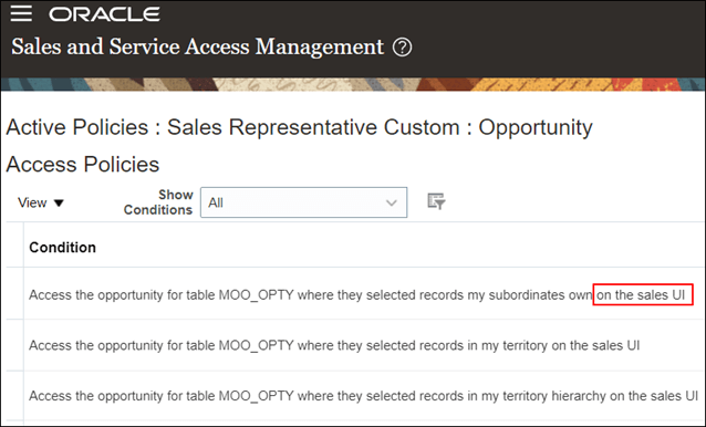

      You can deactivate any policies that grant access based on sales UI privileges. These policies are redundant. The Condition name of these privileges contains a reference to sales UI as shown in the screenshot.
      A screenshot showing the data security policies that grant access based on Sales UI privileges.
