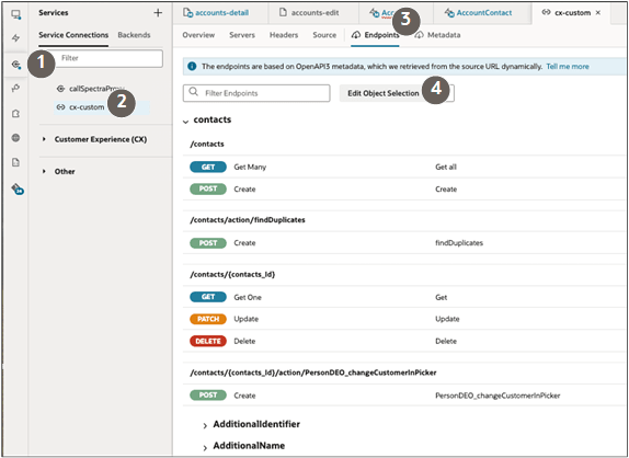

  2. Enable the service connection for the object:
    1. Click the Services tab and the Service Connections subtab.
    2. On the Service Connections subtab, click cx-custom
    3. In the right pane, click the Endpoints tab.
    4. Click the Edit Object Selection button.Image of the Services tab showing the navigation described in the text.
    5. On the Edit Object Selection page, search for and select the custom object that needs to be available in Redwood.
    6. Save.

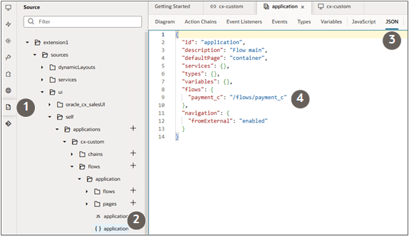

  3. Edit the application JSON:
    1. Click the Source tab.
    2. Open the extension1 folder: extension1 > sources > ui > self > applications > flows > application
    3. Click {}application.
    4. Click the JSON tab in the right pane.
    5. For each object, add the following code in "flows": (
      "<object API name>": "/flows/<object API name>
      Here's an example of an entry for the payment object:
          "payment_c": "/flows/payment_c"
      The complete JSON entry now looks like this:
        "id": "application",
        "description": "Flow main",
        "defaultPage": "container",
        "services": {},
        "types": {},
        "variables": {},
        "flows": {
        "navigation": {
          "fromExternal": "enabled"
      Screenshot of the Source entries in JSON, highlighting the navigation described in the text
