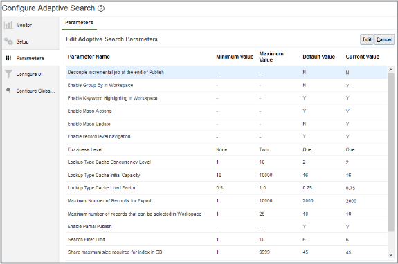

  3. On the Configure Adaptive Search page, click the Parameters tab.
    Screenshot of the Edit Adaptive Search Parameters
  4. Highlight the Parameter Name that you want to change and click Edit. This warning is displayed.
    You're about to change parameters that control how Adaptive Search works.
    Changes should only be carried out by search setup experts. Do you want to
    continue?
  5. Click Yes.
  6. In the Current Value field, makes the changes that you require and click Save and Close.
