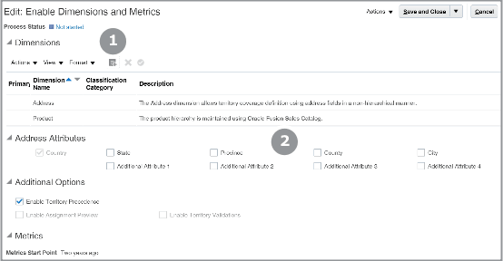

    If you add the Address dimension, the application displays a warning that you can't use territory metrics. Click Yes because you don't need these features.
    Here's a screenshot of the Edit: Enable Dimensions and Metrics page highlighting the location of the Select and Add button (callout 1) and the Address Attributes (callout 2) section where you select the address elements you want to use in territory setup.
    Screenshot of the Edit: Enable Dimensions and Metrics page highlighting the location of the Select and Add button and the address dimension attributes.
  5. If you added the Address dimension, select the address elements you want to use to set up your territories, such as state, city, or postal code. Our simple Vision Corp. example uses state only.
