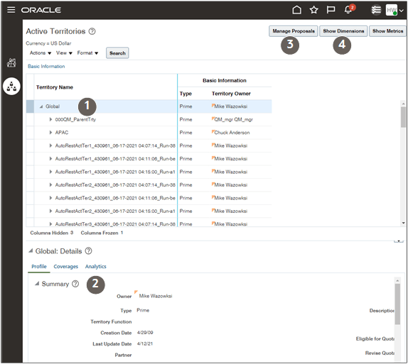

Here's a screenshot of the Active Territories page on the tab. The callouts highlight and describe different features on the page.
Callout Number
Feature Description
1
The left pane of the Active Territories page displays the active territories as a collapsible hierarchy.
2
Selecting a territory, displays territory details at the bottom of the page.
3
Using the Manage Proposals button, you can create territory proposals with your territory changes.
4
The Show Dimensions,Hide Dimensions button lets you toggle the display of dimension details in the list of active territories.
Screen capture of the partial Active Territories page in the More Details UI showing sample data. Regions described in the previous table are highlighted by callouts.

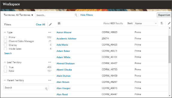

Use Workspace for Resolving Territory Gaps and Overlap Issues
Managers who need to resolve territory gaps and overlap issues in existing territories, can also use Workspace. Both Workspace and the Territories work area let you search for territories not only by salespeople but also by dimension coverage details, such as included accounts, products, or geographies. The territories features in Workspace are the same as in the Territories tab in the Territories work area. What Workspace doesn't have is the ability to create and manage hierarchies. For that you must go to the Territories work area.
Sales territories displayed in Workspace.
