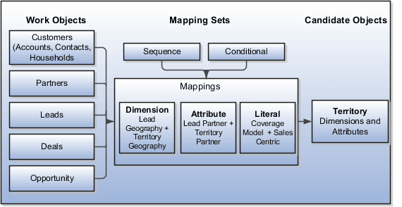

This figure shows an example of the sales application work objects that have associated default mapping sets and mappings. Mapping sets and mappings drive territory-based assignment, and the work object attributes map to the territory candidate object dimensions and attributes.
Figure that identifies work objects that have associated default mapping sets and mappings.

The mappings identify the dimensions, attributes, and territory filtering used in the assignment process. Default mapping sets and their related mappings are predefined for account, lead, partner account, deal, and opportunity revenue assignment. The predefined mapping example assumes that opportunities, leads, sales, partners, accounts, and deals use the same territory hierarchy.
Each predefined mapping set has between 9 and 16 mappings that identify the information about the object, such as the account industry or the sales lead product, and how each is mapped to a dimension or attribute on the territory.
You can create more mappings using the work objects, candidate objects, and attributes that you already established.

Mapping sets enable the grouping of mappings so that you can create more than one mapping for each combination of work object and candidate object. The mapping set concept is used only with territory-based assignment and territory-based assignment with rule filtering. Mappings sets are predefined for accounts, leads, opportunities, partner accounts, and deals. When managing assignment objects, the user can define more mapping sets, each of which contains multiple mappings, for each combination or work object and candidate object.
