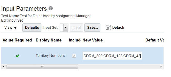

  7. On the Input Parameters dialog box, enter the parameters in the New Value field as shown in the following figure.
    Figure shows an example of the Input Parameters dialog box where user enters parameters in the New Value field
    If you're running the report for multiple territories, enter the territories without spaces. For example, CDRM_300,CDRM_123,CDRM_43. If you enter spaces, the report is run only on the first territory.
