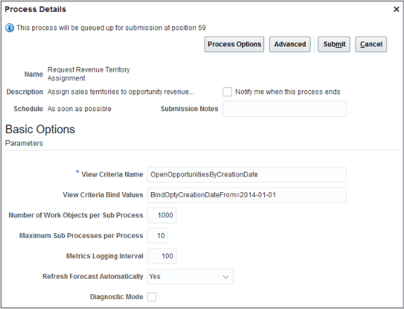

Enter Process Parameters
Enter the process parameters in the Parameters tab of the Process Details window. The process parameters are called "view criteria" in the UI.
Since there are many different options when setting up the view criteria, here we are going to use a simple view based on opportunity creation date. When entering the data, remember that the values are case sensitive, and no spaces are used.
In the View Criteria Name field, enter
OpenOpportunitiesByCreationDateas shown in this figure.
In the View Criteria Bind Values field, enter
BindOptyCreationDateFrom=2014-01-01. This value captures all open opportunities created since January 1, 2014. The format must be yyyy-mm-dd.-
To specify a date range, enter
BindOptyCreationDateFrom=<date>, BindOptyCreationDateTo=<date>. Note the From and To values are separated by a comma. -
Leave the field blank to capture opportunities in the default date range, the past 90 days.
For the purposes of this example, leave the remaining fields at their default values.
Next, schedule the process to run, as described in the next section, Schedule the Process.
