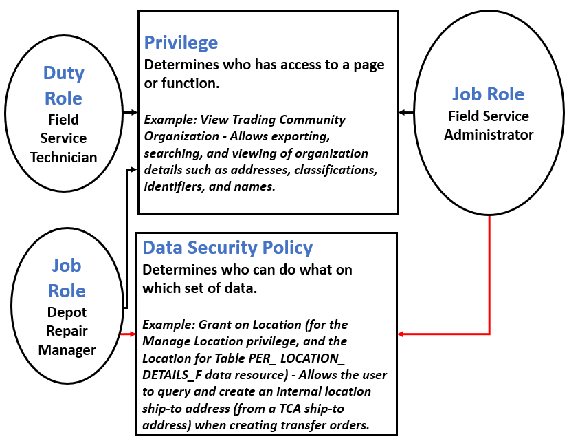

Privileges, Data Security Policies, and Job Roles Example: The following describes how an organization might assign privileges and data security policies to job roles:
  • An organization might have a field service technician duty role, a field service administrator job role, and a depot repair manager job role.
  • The organization might assign each role the privilege that allows exporting, searching, and viewing of organization details such as addresses, classifications, identifiers, and names (View Trading Community Organization privilege).
  • The organization might only assign the field service administrator and the depot repair manager the data security policy that allows the user to query and create an internal location ship-to address (from a TCA ship-to address) when creating transfer orders (Grant on Location data security policy, Location for Table PER_LOCATION_DETAILS_F data resource).
This example is shown in the chart that follows:
Privileges, Data Security Policies, and Job Roles: This diagram is explained in the preceding example.
