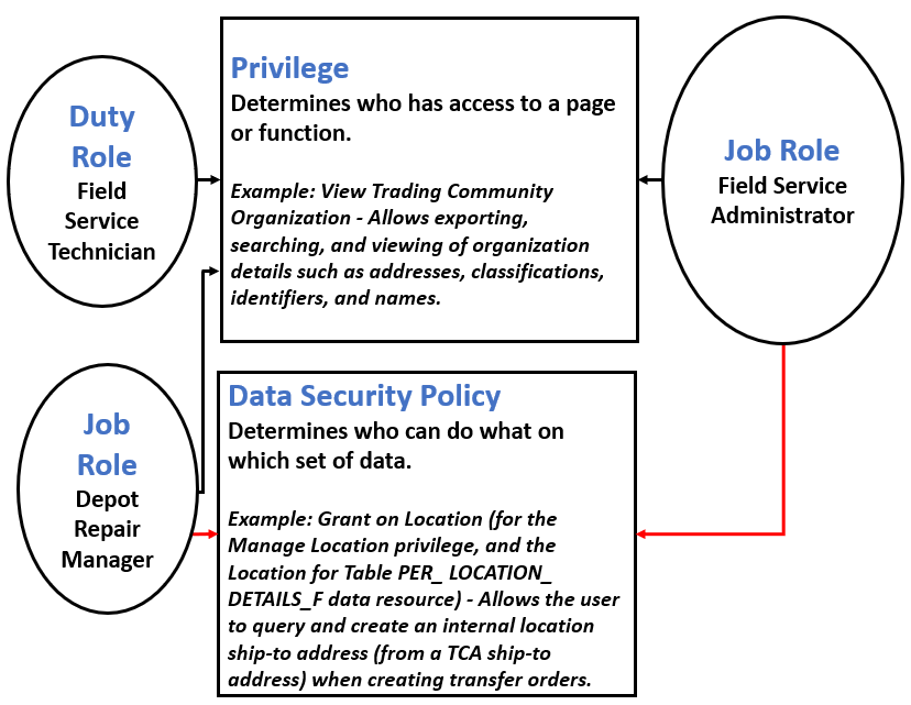

Privileges, Data Security Policies, and Job Roles Example: The following describes how an organization might assign privileges and data security policies to job roles:
  • An organization might have a field service technician duty role, a field service administrator job role, and a depot repair manager job role.
  • The organization might assign each role the privilege that allows exporting, searching, and viewing of organization details such as addresses, classifications, identifiers, and names (View Trading Community Organization privilege).
  • The organization might only assign the field service administrator and the depot repair manager the data security policy that allows the user to query and create an internal location ship-to address (from a TCA ship-to address) when creating transfer orders (Grant on Location data security policy, Location for Table PER_LOCATION_DETAILS_F data resource).
This example is shown in the chart that follows:
Privileges, Data Security Policies, and Job Roles: This diagram is explained in the preceding example.

Assign Data Security Policies to Job Roles
You must set up the data security policies (DSP) for the job roles that you create. A DSP policy is a permission that allows access to a particular set of data.
For specific instructions on how to create a DSP in the Security Console, see the Adding Data Security Policies topic in the Create Roles in the Security Console section of the Securing SCM guide.
The following table shows which DSPs are needed to perform Service Logistics functionality. For some of these data security policies, you must also set up the user data access:
  1. When you're creating a job role, you'll need to add the desired data security policies in the Edit Role page.

  2. Set up the user's data access in the Manage Data Access for Users page.
    Note: Duty roles aren't visible in the Manage Data Access for Users page.
For a listing of the data security policies that are associated with a job role, see the Roles chapter in the Security Reference for Manufacturing and Supply Chain Materials Management Guide.
