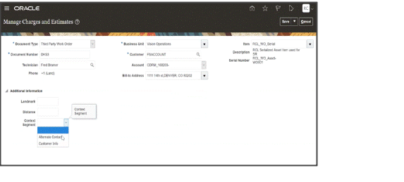

Example 1: Manage Debrief and Charges page
Here you can see an example of custom entities added to the Debrief Headers Attributes flexfield.
This figure shows how custom entities are added to the Debrief Headers Attributes flexfield
            There are two types of flexfields segments here:
Global Segment: These custom attributes are always displayed. In the example above, the Landmark and Distance fields are global segments.
Context Segment: These attributes decide which context-sensitive segments will be displayed. In the example above, Alternate Contact and Customer Info are set up as context segments. When the user selects the context segment Alternate Contact, other attributes such as Customer Name and Phone Number are displayed. These attributes are called context-sensitive segments which are displayed depending on the value of the context segment.

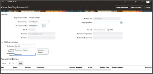

Example 2: Create Part Requirements page
Custom entities added to the Part Requirement Header Attributes flexfield.
This figure shows how custom entities are added to the Part Requirement Header Attributes flexfield
            Note that the Technician field is a global segment. The Technician Contact field is an example of a context-sensitive segment that's displayed only when the context segment Requirement Header is selected.
