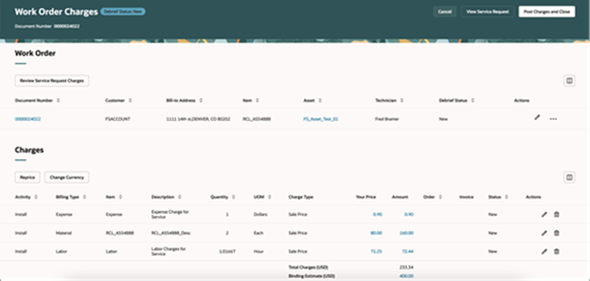

You can use the Work Order Charges Search page to access the Work Order Charges details page. Here you can edit charges before you post them.
To open the Work Order Charges details page from the Work Order Charges Search page:
  1. Click the Manage Charges icon. This opens the Work Order Charges details page.
    Work Order Charges detail page

  3. Add new charges by clicking Add Charges in the Work Order section.
  4. In the Charges table, edit an existing charge by clicking the Edit icon at the line level for any charge line.
    If an approved estimate exists, details of the estimate appear in the Charges table for service request and depot repair charges.
  5. Add and edit manual adjustments to the charge lines by clicking the Your Price link.
  6. Review the applied adjustments by clicking the Amount link.
  7. Optionally, update any charge line that hasn't posted by clicking the Edit icon for that charge line.
  8. Reprice the charge lines based on your pricing strategy setup by clicking the Reprice button.

  11. Post the work order charges by clicking Post Charges and Close.
    When you post charges, Service Logistics creates a maintenance work order for each new asset that you’ve debriefed.
