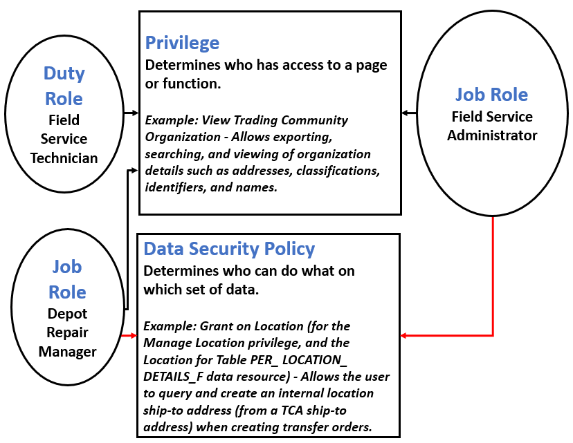

You can create users for the functionality that you plan to use.
Overview of Assigning Privileges and Data Security Policies to Job Roles
When you create job roles you'll assign privileges to decide the pages and functions that the job role can access. You'll also assign data security policies (DSPs) to give the role access to the data that has data security.
Service Logistics has some established DSPs for its predefined job roles, however, you must create your own DSPs when you create your unique roles. This is different than the predefined privileges, which you'll simply need to associate with the roles that you create. For more details see the Enable Service Logistics Functionality by Assigning Privileges for Users and Assign Data Security Policies to Job Roles topics.
Use the Security Console to manage job roles, privileges, and data security policies. For more information see the Securing SCM guide.
- An organization might have a field service technician duty role, a field service administrator job role, and a depot repair manager job role.
- The organization might assign each role the privilege that allows exporting, searching, and viewing of organization details such as addresses, classifications, identifiers, and names (View Trading Community Organization privilege).
- The organization might only assign the field service administrator and the depot repair manager the data security policy that allows the user to query and create an internal location ship-to address (from a TCA ship-to address) when creating transfer orders (Grant on Location data security policy, Location for Table PER_LOCATION_DETAILS_F data resource).
This example is shown in the chart that follows:
Privileges, Data Security Policies, and Job Roles Example

Field Service Technician Duty |
Technician Access for Receive Parts |
RCL_FSTECH_RECEIVE_PARTS |
Allows the technician access to the Receive Parts page. |
Depot Repair Manager Field Service Administrator Field Service Technician Duty |
Update Maintenance Work Orders by Service |
MNT_UPDATE_WORK_ORDERS_BY_SERVICE |
Allows the ability to call update for the SCM Work Order REST API to update the status. |
Update OTBI Layout for Service Logistics Landing Page |
RCL_CONFIGURE_OTBI_REPORTS_LANDING_PAGE_PRIV |
Allows the user to configure the Oracle Transactional Business Intelligence (OTBI) reports on the Service Logistics landing page. Redwood |
Update Sales Orders Using REST Services | FOM_SALES_ORDER_REST_PATCH_PRIV |
Allows the users to update sales orders using REST Services. Used in the Depot Repair UI. Redwood |
Use Location Service |
PER_USE_LOCATION_SERVICE |
Allows the use of the location service. |
Use REST Service - Guided Journeys Read Only |
ORA_PER_REST_SERVICE_ACCESS_GUIDED_JOURNEYS_RO |
Allows the user to call the GET method associated with the Guided Journeys REST service. |
Use REST Service - Guided Journey Responses |
ORA_PER_REST_SERVICE_ACCESS_GUIDED_JOURNEY_RESPONSES |
Allows the user to call all methods associated with the Guided Journey Responses REST service. |
Field Service Administrator |
Use REST Service to Edit Service Request |
SVC_EDIT_SR_USING_REST_PRIV |
Allows editing a service request using REST API. |
Use REST Service to View Service Request |
SVC_VIEW_SR_USING_REST_PRIV |
Allows viewing of service requests using REST API. |
View Customer Assets |
CSI_VIEW_CUSTOMER_ASSETS |
Allows the user to query and view customer assets, related configurations, and structures. |
View Global Inventory Organizations List of Values by Web Service |
RCS_GLOBAL_VIEW_INV_ORG_LOV_WEB_SERVICE_PRIV |
Allows viewing the global set of inventory organizations list of values by web service. |
View Item Lot and Item Serial List of Values by Web Service |
INV_VIEW_LOT_SERIAL_LOV_WEB_SERVICE_PRIV |
Allows viewing lot and the serial number list of values using web service. Redwood |
View Inventory Transaction List of Values by Web Service |
INV_VIEW_INVENTORY_TRANSACTION_LOV_WEB_SERVICE_PRIV |
Allows viewing inventory transaction account, inventory transaction reason, inventory account alias, and inventory transaction type list of values using web service. Redwood |
View Maintenance Work Orders by Service |
MNT_GET_WORK_ORDERS_BY_SERVICE |
Allows the ability to get details about existing SCM work orders using REST API. |
View Orders |
FOM_VIEW_ORDERS_PRIV |
Allows the users to view orders. |
View Planning Supply Availability |
MSP_VIEW_PLANNING_SUPPLY_AVAILABILITY |
Required by Service Request and Work Order to use Global Order Promising to source the parts. |
View Receivables Invoice |
AR_VIEW_RECEIVABLES_INVOICE |
Allows access to view a receivables invoice. |
Depot Repair Manager Field Service Administrator |
View Requirement Lines |
RCL_PARTS_REQ_VIEW |
Allows access to Parts Requirement region for the Fusion Service work order creation page, and the Manage Parts Requirement page. |
View Requisition | POR_VIEW_REQUISITION |
Allows users to view requisition details. Redwood |
View Requisition – All |
POR_VIEW_REQUISITION_ALL_PRIV |
Allows users to create approved requisitions through the requisition import program. Used in the Parts Requirements UI to cancel purchase requisitions. Redwood |
Depot Repair Manager |
View Reverse Logistics Lines |
RCL_REVERSE_LOGISTICS_LINES_SERVICE |
Allows the user to view reverse logistics using a service. Redwood |
SVC_VIEW_SR_PRIV |
Allows viewing of service requests. |
View Service Work Order |
SVC_VIEW_SERVICE_WORK_ORDER_PRIV |
Allows viewing of service work orders. |
View Spares Item Status |
RCL_SPARES_ITEM_STATUS_SERVICE |
Allows the user to view an item status. Redwood |
View Subscription Adjustments |
RCL_VIEW_SUBSCRIPTION_ENTITLEMENTS_BY_SERVICE |
Allows access to subscription entitlements for contract discounts in the Charges and Parts Requirement page. |
View Subinventory and Locator List of Values by Web Service |
INV_VIEW_SUBINVENTORY_LOCATOR_LOV_WEB_SERVICE_PRIV |
Allows viewing subinventory and locator list of values using web service. Redwood |
View Subscription Entitlements |
OSS_VIEW_SUBSCRIPTION_ENTITLEMENTS |
Allows the ability to change the subscription user status. |
View Technician Portal Work Orders |
RCL_PORTAL_VIEW_WO |
Allows access to the Manage Work Orders and Charges page. |
View Trading Community Organization |
HZ_VIEW_TRADING_COMMUNITY_ORGANIZATION |
Allows exporting, searching, and viewing of organization details such as addresses, classifications, identifiers, and names. |
View Trunk Stock |
RCL_PORTAL_VIEW_TRUNK_PARTS |
Allows the user view access to the Manage Field Parts Inventory page. |
View Units Of Measure List of Values by Web Service |
RCS_VIEW_UNITS_OF_MEASURE_LOV_WEB_SERVICE |
Allow viewing units of measure list of values by web service. Redwood |
