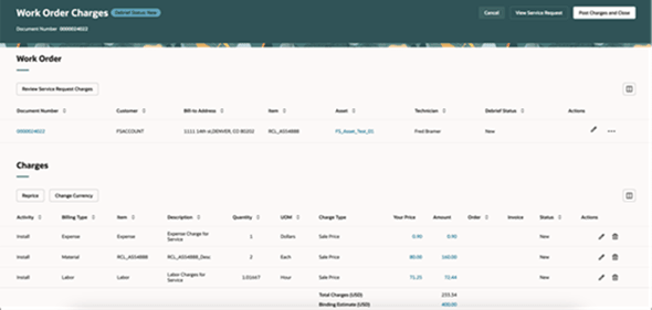

You can use the Work Order Charges Search page to access the Work Order Charges details page. Here you can edit charges before you post them.
To open the Work Order Charges details page from the Work Order Charges Search page:
  1. Click the Manage Charges icon. This opens the Work Order Charges details page.
    Work Order Charges detail page
  2. Before posting charges, in the Work Order table:
    • Review the work order header information.
    • Edit the header details by clicking the Edit icon.
      • You can update the Service Address field on the Edit Work Order Charges page. This field defaults from the associated service work order. Select any ship-to addresses to calculate sales taxes, when you're pricing field service charges. If you update the service address, all charge lines will be repriced. After the charges post, the service address is used for the sales order ship-to addresses, and passed to Accounts Receivable for calculating sales tax.
      • Charge lines are also repriced when you update the asset on debrief header as it might have a different subscription coverage.
  3. Add new charges by clicking Add Charges in the Work Order section.
  4. In the Charges table, edit an existing charge by clicking the Edit icon at the line level for any charge line.
    If an approved estimate exists, details of the estimate appear in the Charges table for service request and depot repair charges.
  5. Add and edit manual adjustments to the charge lines by clicking the Your Price link.
  6. Review the applied adjustments by clicking the Amount link.
  7. Optionally, update any charge line that hasn't posted by clicking the Edit icon for that charge line.
  8. Reprice the charge lines based on your pricing strategy setup by clicking the Reprice button.
