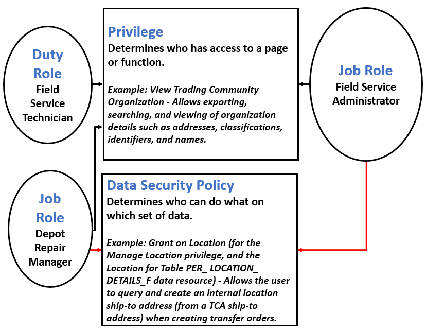

Overview of Assigning Privileges and Data Security Policies to Job Roles
When you create job roles you'll assign privileges to decide the pages and functions that the job role can access. You'll also assign data security policies (DSPs) to give the role access to the data that has data security.
Service Logistics has some established DSPs for its predefined job roles, however, you must create your own DSPs when you create your unique roles. This is different than the predefined privileges, which you'll simply need to associate with the roles that you create. For more details see the Enable Service Logistics Functionality by Assigning Privileges for Users and Assign Data Security Policies to Job Roles topics.
Use the Security Console to manage job roles, privileges, and data security policies. For more information see the Securing SCM guide.
Privileges, Data Security Policies, and Job Roles Example: The following describes how an organization might assign privileges and data security policies to job roles:
  • An organization might have a field service technician duty role, a field service administrator job role, and a depot repair manager job role.
  • The organization might assign each role the privilege that allows exporting, searching, and viewing of organization details such as addresses, classifications, identifiers, and names (View Trading Community Organization privilege).
  • The organization might only assign the field service administrator and the depot repair manager the data security policy that allows the user to query and create an internal location ship-to address (from a TCA ship-to address) when creating transfer orders (Grant on Location data security policy, Location for Table PER_LOCATION_DETAILS_F data resource).
This example is shown in the chart that follows:
Privileges, Data Security Policies, and Job Roles: This diagram is explained in the preceding example.
