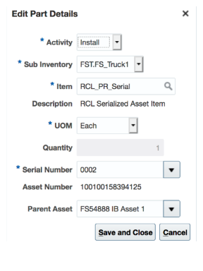

      • You can capture the parent asset details along with the serial number of the issued part during the debrief process. This ensures that the asset hierarchy is updated simultaneously in Installed Base. You can do this in both the Add Part Details window (when creating a new part debrief line) and the Edit Part Details window(when editing an existing part debrief line). Note that the parent asset on the part install debrief transactions defaults from the asset on the work order.
        Edit Part Details
        Field
        Description
        Asset Number
        Displays the asset number for the serial number entered. This field is displayed only when the service activity selected is Install and the selected item is an asset tracked item and is serial controlled.
        Parent Asset
        List of values displays Installed Base assets that are already part of the debrief header asset's configuration. This field is displayed only when the service activity selected is Install and the selected item is an Installed Base asset. The parent asset information collected during the debrief process is used to update the Installed Base configuration and hierarchy for the debrief asset.

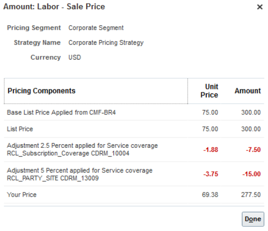

  3. Click the Charges tab. You'll see the summary of all charges incurred on the work order and the total amount that will be invoiced to the customer. The Estimated Total Amount field on the Charges tab gives you the total work order estimate. You can compare the estimated amount with the final charges and make adjustments as required before posting the charges.
  4. The final price is calculated after applying the warranty and all service contracts discounts for the customer and asset. To see the discounts that have been applied, click the amount displayed for each debrief line. For example, click the amount displayed for item Labor.
  5. A dialog box will open displaying all the pricing components and the corresponding charges. Here you can see the discounts that have been applied.

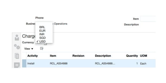

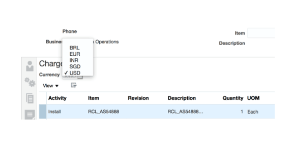

  7. You can also change the currency that's used to bill the customers for the services provided. The Currency field displays the default currency in which the current charges are calculated. Click the drop-down button to select another currency. All existing charge lines will be repriced using the new currency exchange rate. This is useful when the default currency returned from Pricing isn't correct or when you want to generate customer invoices in their local currency. Note that the Currency drop-down list displays the currencies derived from the pricing strategy.
    Change Currency
