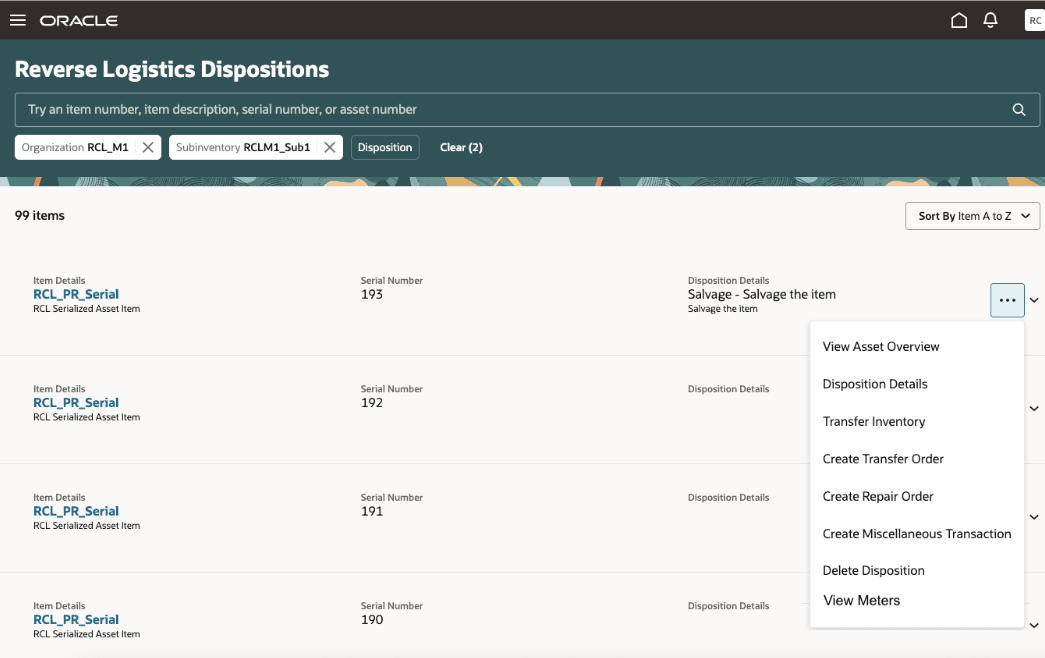

Reverse Logistics Disposition results table
The Reverse Logistics Disposition results table lists the items based on your search criteria and filters.
From the search results, you can take the following actions for each item:
  • View Asset Overview: Opens the Maintenance Asset Overview page.
  • Disposition Details: Opens the New Disposition Details page.
  • Transfer Inventory: Opens a side drawer to perform inventory transactions.
  • Create Transfer Order: Opens a side drawer to create transfer orders.
  • Create Repair Order: Opens a side drawer to create a repair order and allows you to capture a work order description.
  • Create Miscellaneous Transaction: Opens a side drawer to create transactions.
  • Delete Disposition: Deletes a disposition record for a returned item before any inventory or repair order transactions are performed.
  • View Meters: Opens a side drawer that allows you to view a meter and review its full reading and usage history and capture meter readings.
The disposition record for an item will be closed and removed from the Search page once any inventory transaction is performed for that item, like when you transfer inventory or create a miscellaneous transaction. However, the record remains open if a maintenance work order is created, because multiple work orders can be created for the same item. An item will also be cleared from the Reverse Logistics Dispositions page when it's moved out of a valid stocking location.
