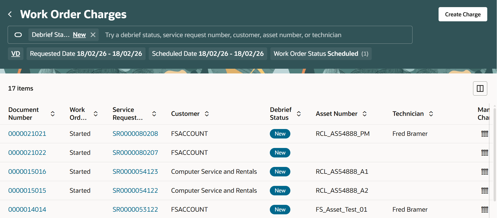

Work Order Charges search page

The Work Order Charges search page includes the:
  • Search bar
  • Filter Chips suggestions bar
  • Magnifying Glass icon
  • Charges results table
These are described in the following table:

Search bar
Note: Technicians will only see the work order charges assigned to them.
The search bar opens with filter chips, which you can add or delete depending on your search needs. The selectable filter chips include:
  • Work Order Area (LOV: Filters by the work area on the Fusion Service work order that’s associated with the charges. It doesn’t apply to third-party work order charges).
  • Debrief Status (LOV)
  • Resolution Due Date (range)
  • Work Order Status (LOV: Filters by the status of the Fusion Service work order that’s associated with the charges. It doesn’t apply to third-party work order charges).
  • Requested Date (range)
  • Scheduled Date (range)

Field Chips suggestion bar
The filter chips appear in the Search bar and provide suggestions for filtering your results set. For example, you might see a filter suggestion for a date range for the work order’s requested date. You can select this filter chip to filter your results.
When you select one of the filter chips in the suggestions bar, it’s added to the Search bar and filters the Charges results table.
The Charges results table lists the work order charges based on your search criteria and filters. You can also sort your results by selecting the arrows next to the column headers. When you first open the page, the work order charges are sorted by the document number.
To edit existing work order charges, you can open the Work Order Charges details page by selecting the Manage Charges icon. Then, select the Asset link in the Work Order Charges details page and navigate to the Maintenance Asset Overview page.
To enter new charge lines, you can open the Work Order Charges header page by selecting the Create Charge button.
