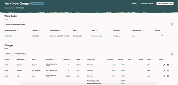

    Work Order Charges Detail Page
  2. Before posting charges, in the Work Order table:
    • Review the work order header information.
    • Edit the header details by selecting the Edit icon.

  3. Select the Asset link to navigate to the Maintenance Asset Overview page.
  4. Add new charges by selecting Add Charges in the Work Order section.
  5. In the Charges table, edit an existing charge by selecting the Edit icon at the line level for any charge line.
    If an approved estimate exists, details of the estimate appear in the Charges table for service request and depot repair charges.
  6. Add and edit manual adjustments to the charge lines by selecting the Your Price link.
  7. Review the applied adjustments by selecting the Amount link.
  8. Optionally, update any charge line that hasn't posted by selecting the Edit icon for that charge line.
  9. Reprice the charge lines based on your pricing strategy setup by selecting the Reprice button.
