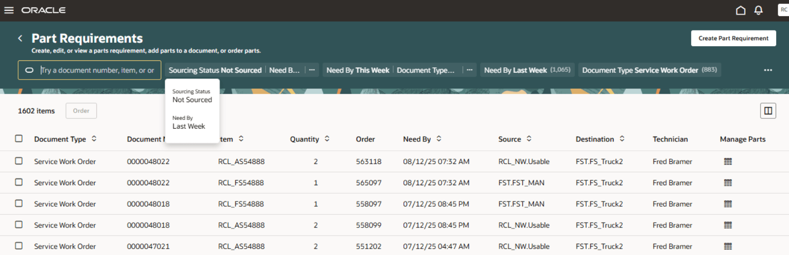

The Part Requirements search page includes the:
  • Search bar
  • Filter Chips suggestions bar
  • Magnifying Glass icon
  • Part Requirements results table
These are described in the following table:
The filter chips appear in the Search bar and provide suggestions for filtering your results set. For example, you might see a filter suggestion for a document type for the part requirements. You can select this filter chip to filter your results.
When you select one of the filter chips in the suggestions bar, it’s added to the Search bar and filters the results table.
You can use the Magnifying Glass icon to filter your results based on predefined filter chips and their associated values. Specifically, the magnifying glass shows filter chips with preselected values. Some examples are:
  • Need By: Last Year
  • Document Type: Service Request
  • Sourcing Status: Not Sourced
  • Ship-to Address Type: Customer
The Part Requirements results table lists the part requirements based on your search criteria and filters. You can also sort your results by selecting the arrows next to the column headers. When you first open the page, the part requirements are sorted by the document type.
You can select the Submit Order button for a selected part line to create transfer orders or reservations for parts.
Note: The Submit Order button is disabled if the part line is either a service request or a service work order with a transfer order or reservation that already exists.
