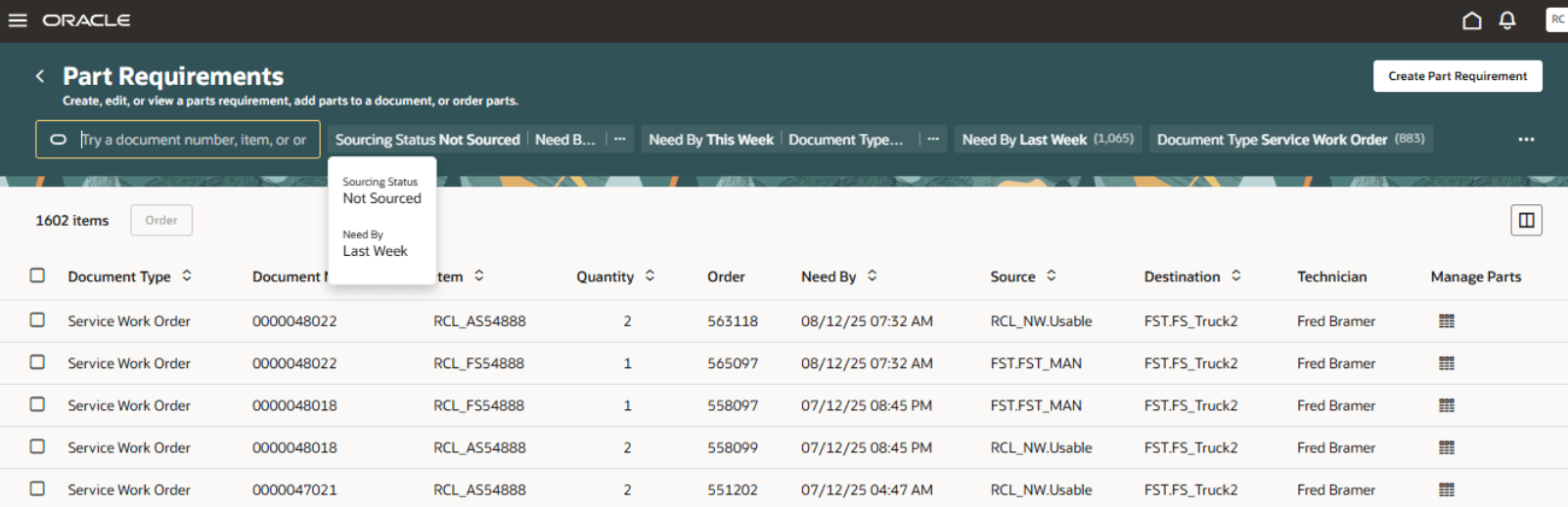

Part Requirements Search Page

The search bar opens with filter chips, which you can add or delete depending on your search needs. The selectable filter chips include the following lists:
  • Need By
  • Document Type
  • Sourcing Status
  • Ship-to Address Type
  • Work Order Area
Note: The search can display multiple filter chips as a single combined search. If you apply one or more filters, select out of the search bar for a few seconds, and then select a record in the table, the selected criteria are saved as a recent search filter. For example, if you search using the Sourcing Status and Need By filter chips, this criteria are combined into a new filter chip.
By default, the search page lists part requirements with Need By set to "This Week."

Filter Chips suggestions bar
The filter chips appear in the Search bar and provide suggestions for filtering your results set. For example, you might see a filter suggestion for a document type for the part requirements. You can select this filter chip to filter your results.
When you select one of the filter chips in the suggestions bar, it’s added to the Search bar and filters the results table.
Magnifying Glass icon
You can use the Magnifying Glass icon to filter your results based on predefined filter chips and their associated values. Specifically, the magnifying glass shows filter chips with preselected values. Some examples are:
  • Need By: Last Year
  • Document Type: Service Request
  • Sourcing Status: Not Sourced
  • Ship-to Address Type: Customer
Part Requirements results table
The Part Requirements results table lists the part requirements based on your search criteria and filters. You can also sort your results by selecting the arrows next to the column headers. When you first open the page, the part requirements are sorted by the document type.
You can select Submit Order for a selected part line to create transfer orders or reservations for parts.
Note: Submit Order is disabled if the part line is either a service request or a service work order with a transfer order or reservation that already exists.
