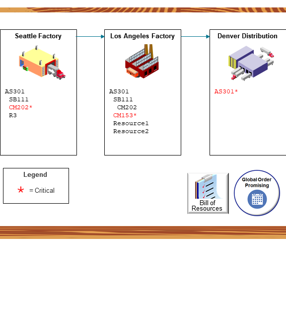

Detailed Lead Time Example
Consider this flow.
Note
- The assembled AS301 item is critical in the Denver Distribution Center.
- Subassembly SB111 in the Los Angeles Factory isn't critical.
- The CM202 item in the Seattle Factory is critical, and it is two levels below the AS301.
- The CM153 item in Los Angeles is critical, and it is one level below the AS301.
- You have done all the required Promising setups, such as sourcing rules, assignment sets, ATP rules, and so on.

Here are the lead times that the scheduled process creates in your bill of resources.
Assembly | Assembly Organization | Component | Component Organization | Lead Time |
AS301 | Denver | CM202 | Seattle | 17 days |
AS301 | Denver | CM153 | Los Angeles | 11 days |
Here's the calculation for the CM202's 17 day lead time.
Lead Time Calculation for the CM202 | Running Total |
1 day processing plus 1 day postprocessing for the SB111 in Seattle equals 2 days | 2 |
3 days transit time to get from Seattle to Los Angeles
2 + 3 = 5 |
1 day postprocessing for the SB111 in Los Angeles | 5 + 1 = 6 |
2 days processing plus 3 days postprocessing for the AS301 in Los Angeles equals 5 more days | 6 + 5 = 11 |
2 day transit time to get from Los Angeles to Denver | 11 + 2 = 13 |
4 days postprocessing for the AS301 in Denver | 13 + 4 = 17 |
