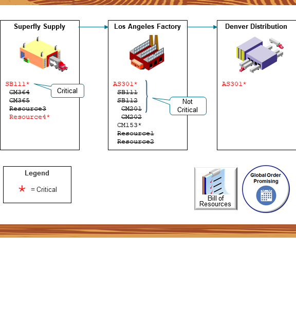

- Your supplier creates the SB111 subassembly.
- You transfer the SB111 to your Los Angeles factory, then use it to create the AS301 assembled item in Los Angeles.
- You transfer the AS301 from Los Angeles to the Denver distribution center.
- You ship it from Denver to your customer.
- The asterisk means critical.
- Strikethrough means you still need the item or resource, but the scheduled process doesn't consider it because its already part of the critical item. For example, in Los Angeles, the AS301 is critical. SB111, SB112, CM201, and CM202 are a part of the AS301, but they aren't critical. This is a good example where using a bill of resources is more efficient and saves you a lot of time. It isn't necessary to consider the items that aren't critical when you create a bill of resources.

Assume you set up all your sourcing rules, assignment sets, transit times, and so on. The scheduled process will create this bill of resources:
Assembly | Assembled Quantity | Organization | Component | Usage Quantity | Lead Time | Resource | Resource Quantity |
SB111 | 1 | Superfly Supply | - | - | 2 days | R4 | 0.30 hours |
AS301 | 1 | Los Angeles | CM153 | 1 unit | 4 days | - | - |
- | 1 | Superfly Supply | SB111 | 1 unit | 4 to make plus 1 to transfer | - | - |
The lead time for the AS301 is:
- 2 days to make the SB111.
- 1 day to transfer it from Superfly Supply to Los Angeles.
- 4 days to make the CM153.
