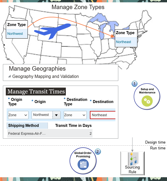

Here's an overview:
- You use the Setup and Maintenance work area to set up your zones, validate them, and then set up your transit times.
- At run time, Global Order Promising uses your geography as input to the sourcing rule that it uses to promise your item.

Try It
Assume you need to allocate supply according to the hierarchy described in Get Supply from a Node's Parent. For brevity, this topic describes only how to set up the geography between the Northwest zone and the Northeast zone.
Summary of the Setup
- Set up your zones.
- Manage the geography.
- Manage the transit time.
This topic uses example values. You might need different values for your implementation.
