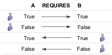

Requires
If you select an option, then Oracle Configurator applies the same value to the other option.
The effect of the Requires relation
If you:
  • Select option a, then Configurator also selects option b.
  • Deselect option a, then Configurator also deselects option b.
  • Select option b, then Configurator also selects option a.
  • Deselect option b, then Configurator also deselects option a.

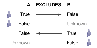

Implies
Here's how an Implies rule works.
The effect of the Implies relation
If you:
  • Deselect option a, then Configurator deselects option b, and you can select or deselect option b.
  • Select option b, then Configurator deselects option a, and you can select or deselect option a.

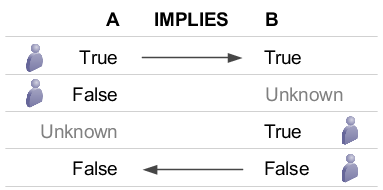

Excludes
Here's how an Excludes rule works.
The effect of the Excludes relation
If you:
  • Select option a, then Configurator deselects option b and prevents you from selecting b because the rule excludes b from the configuration.
  • Deselect option a, then option b becomes available and you can select or deselect option b.
  • Select option b, then Configurator deselects option a and prevents you from selecting option a.
  • Deselect option b, then option a becomes available and you can select or deselect option a.
