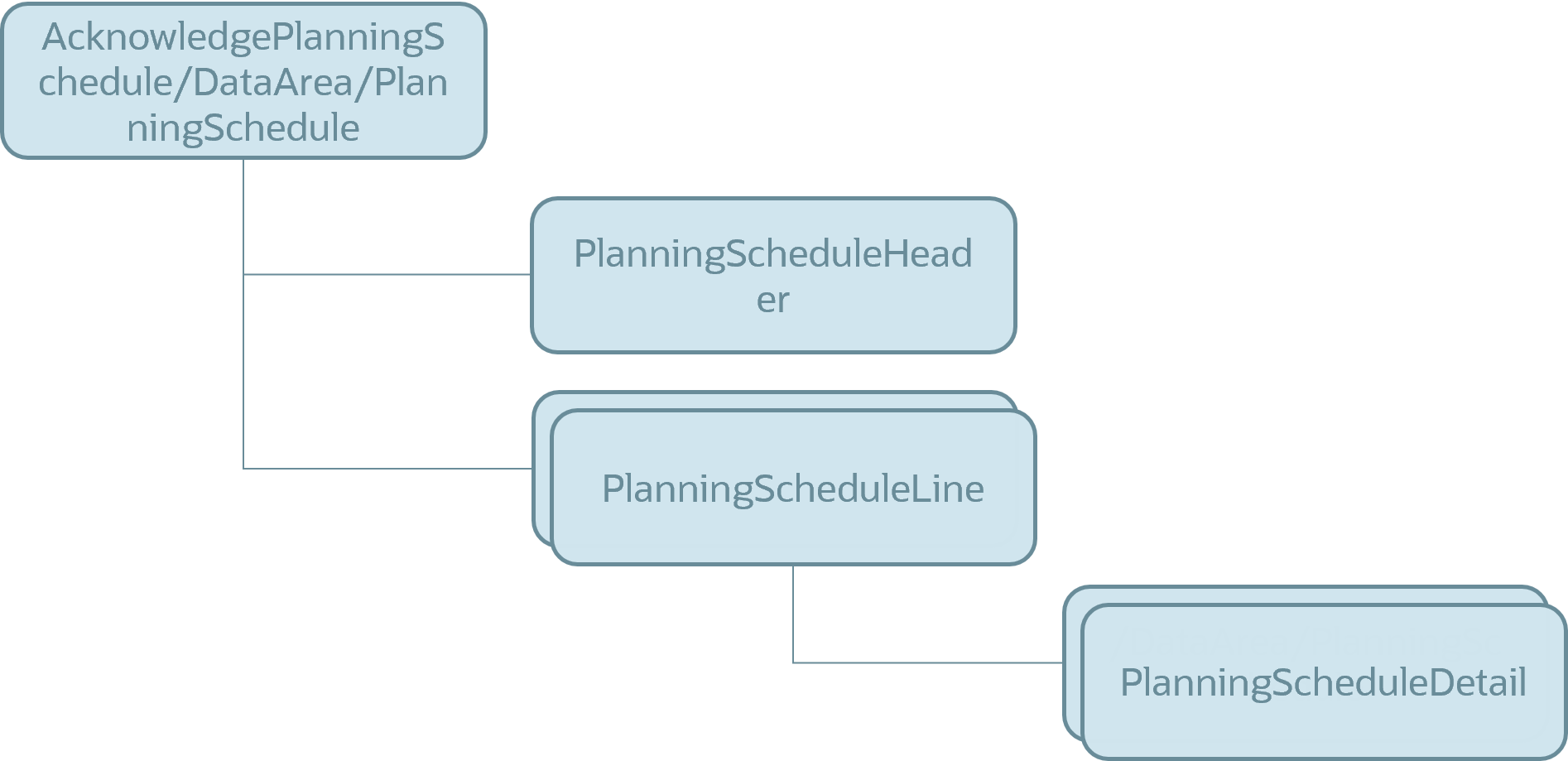

This diagram shows the structure of the inbound OAGIS 10.1 payload.

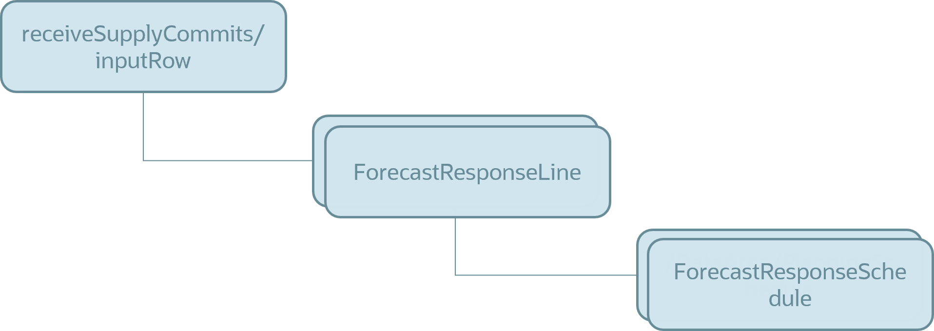

This diagram shows the structure of the payload that's passed on to the application service.
This table shows where the data received in the predefined OAGIS_10.1_ACKNOWLEDGE_PLANNING_SCHEDULE_COLLAB_MSG_IN and the OAGIS_10.1_ACKNOWLEDGE_PLANNING_SCHEDULE_IN message payloads is mapped to in the payload that is passed on to the application service.
