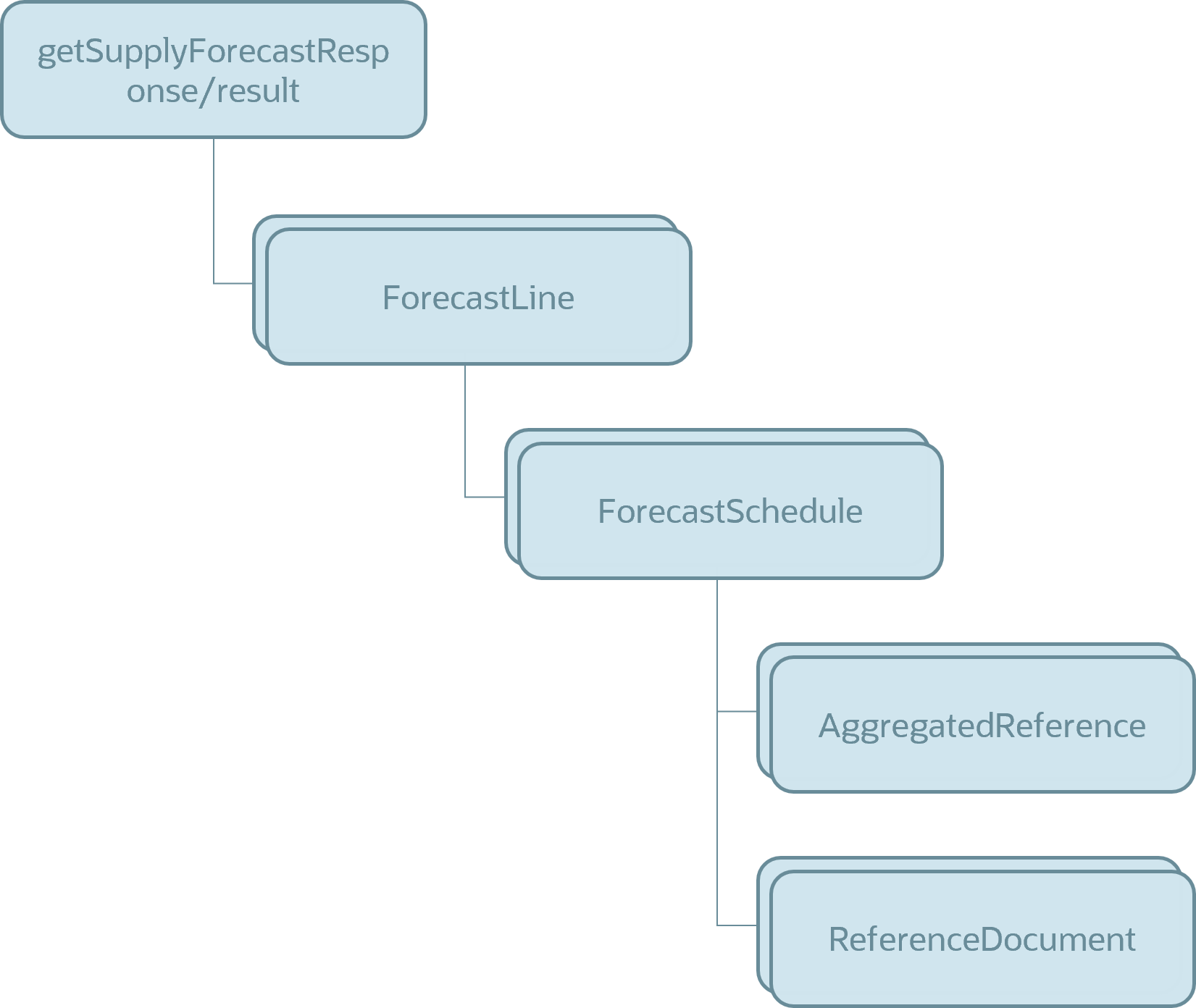

Data Mapping
This diagram shows the structure of the payload that's passed from the application server.

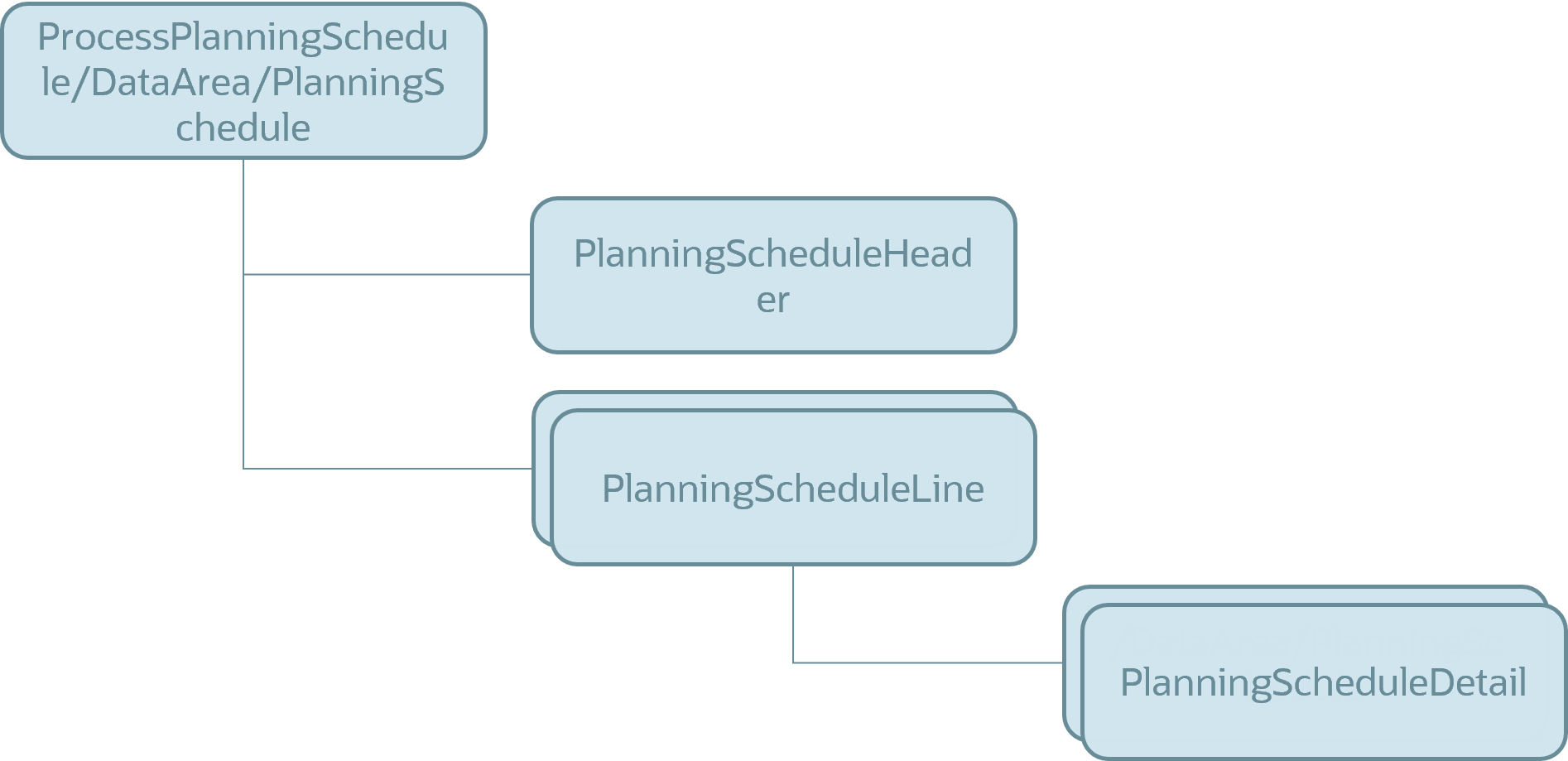

This diagram shows the structure of the outbound OAGIS 10.1 payload.
