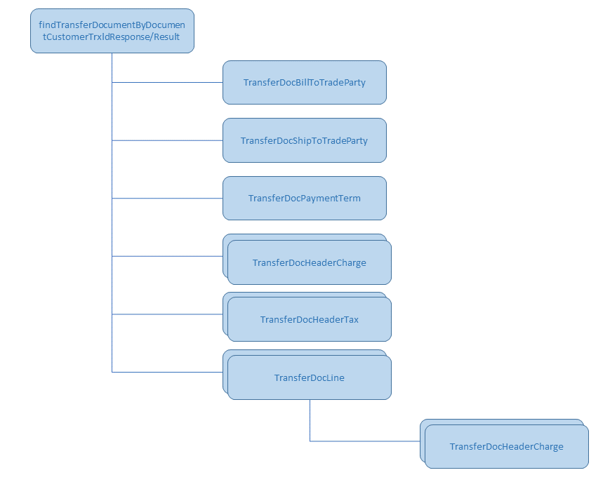

The below figure shows the structure of the payload that's received from the application for the UBL-2.1-PEPPOL-Invoice-Out-V2 message.
Screen capture that shows the payload structure received from the application for the message.
