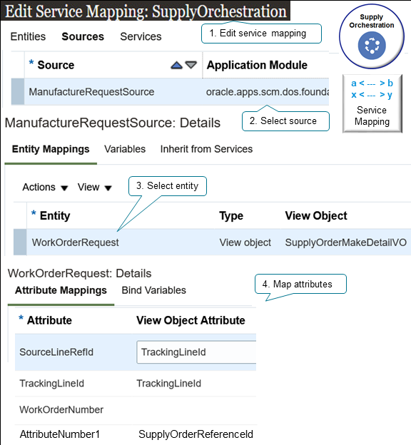

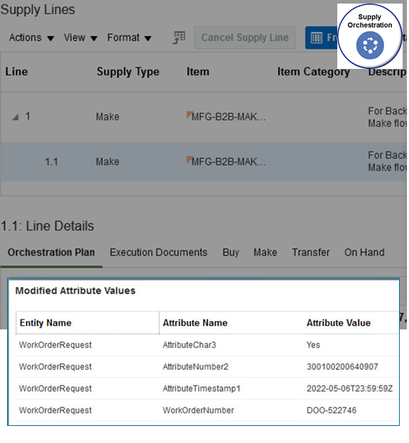

Here's an example service mapping that uses the WorkOrderRequest entity in the ManufactureRequestSource source.
Here's what it does.
- Sends a request to create a work order from Supply Chain Orchestration to Manufacturing
- Uses the WorkOrderNumber attribute to send the work order number
- Uses the AttributeNumber1 attribute to send the SupplyOrderReferenceId
