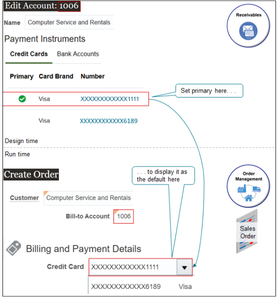

Add New Credit Card and Make it the Primary
Assume you need to add a credit card for your Computer Service and Rentals customer and make it the primary card.
Note
You add a credit card to the account in the Accounts Receivable work area.
You can set the card as the primary card when you add it.
At run time, Order Management selects and displays the primary card, by default. It also makes the other cards that you add in the Accounts Receivable work area available on the sales order.

On the Edit Account page, in the Payment Instruments area, in the Credit Cards list, click Create a Credit Card. Its the icon that looks like a page.

Click Billing and Payment Details.
On the Billing and Payment Details tab, set the value.
Attribute
Value
Payment Method
Credit Card
In the Payment Details area, verify that the attribute value defaults to the primary card.
Attribute
Value
Credit Card
XXXXXXXXXXXX1111
