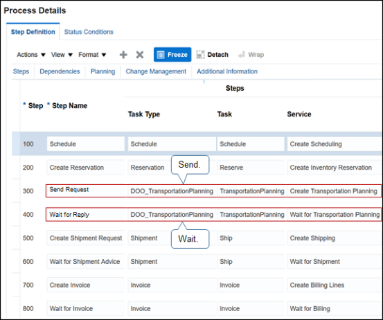

Set Up Orchestration Process
Add an orchestration process step that sends a request to Transportation Management. Add another step that waits for the reply.
Note
Use the predefined DOO_TransportationPlanning task type in the orchestration process. This task type allows Order Management to send a new request to the transportation management system, and to update or cancel a request that already exists.
Reference DOO_TransportationPlanning at any point in the stepwise sequence of an orchestration process, depending on your business requirements. For example, set up an orchestration process so it identifies the source of supply, reserves inventory, then plans transportation.
Wait for the response.
It might be necessary to wait for a response from Transportation Management in some situations. For example, an order release is a representation of the sales order in Transportation Management. Transportation Management uses the sales order as input to create the order release.
If Transportation Management can't successfully create the release, for example, an attribute that it requires for planning transportation is missing a value, then it might be useful to prevent the orchestration process from proceeding, such as to a ship item step, until the Order Manager can determine whether to allow the process to proceed without the release.
To add a wait step, copy the Send Request step, then modify the copy as necessary.
Use the DOO_TP_REQ_ACCEPTED value or the CANCELED value in the Status Code attribute as the exit criteria for the wait step.
The flow won't proceed to the next step until Transportation Management replies that it successfully created the sales order release.
Don't wait for a response unless you need it to meet a business requirement. Waiting for the response increases the possibility that the orchestration process might take a long time to finish, or get stuck waiting for the response.

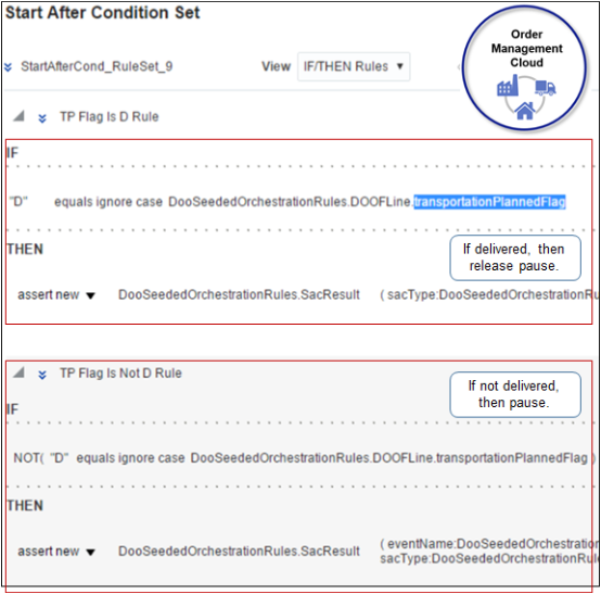

Get Delivery Confirmation
As an option, add a pause step to make sure invoicing finishes before confirming delivery.
Add a pause step that's similar to the Shipping step in the orchestration process.
Get delivery confirmation at different points in the orchestration process, such as Awaiting Billing.
For example, to prevent the Invoice step from running before confirming delivery, add a pause step before the invoice step, then set up the pause so it waits until Order Management receives delivery confirmation.
Use the SAC_SYSTEM_EVENT_POD_PAUSE event and the TransportationPlannedFlag attribute.
Use SAC_SYSTEM_EVENT_POD_PAUSE to release the pause when Transportation Management sends the DOO_TP_DELIVERED status.
Make sure the orchestration process is on a wait step when it receives the response.
The status description for DOO_TP_DELIVERED is Shipment Delivered. However, if you use a pause to get delivery status, then Shipment Delivered doesn't display. Instead, set up a pause status that displays Shipment Delivered.
Click Click for Rule on the pause step, then create two pause rules.
Order Management releases SAC_SYSTEM_EVENT_POD_PAUSE after it receives delivery confirmation so you can use this event to process a subsequent sales order.
Rule 1
Create the rule that releases the pause task.
If
"D" equals ignore case DooSeededOrchestrationRules.DOOFLine.TransporationPlannedFlag
then
assert new DooSeededOrchestrationRules.SacResult (sacType:DooSeededOrchestrationRules.SacResult.SAC_TYPE_IMMEDIATE)
where
Code |
Description |
D means Delivered. |
If the TransporationPlannedFlag attribute on the fulfillment line contains D. |
Then immediately release the pause task and continue to the next step in the orchestration process. |
Rule 2
Create the rule that pauses the orchestration process.
If
NOT ("D" equals ignore case DooSeededOrchestrationRules.DOOFLine.TransporationPlannedFlag )
then
assert new DooSeededOrchestrationRules.SacResult (eventName:DooSeededOrchestrationRules.SacResult.SAC_SYSTEM_EVENT_POD_PAUSE, reevaluateFlag:"Y",sacType:DooSeededOrchestrationRules.SacResult.SAC_TYPE_EVENT)
where
Code |
Description |
If TransporationPlannedFlag on the fulfillment line doesn't contain D. |
Then
For details about how to create a pause rule, see Pause Orchestration Processes for Events.

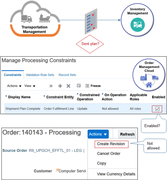

Prevent Changes After Transportation Planning Finishes
If you use Oracle Inventory Management before Update 18C, then enable the predefined Shipment Plan Complete processing constraint.
Note
Shipment Plan Complete prevents you from revising the order line in the Order Management work area after Transportation Management sends the transportation plan to Inventory Management. This constraint comes predefined as disabled. You can enable it during set up.
Before Update 18C, Inventory Management supports only a quantity change or order cancel after Transportation Management sends the transportation plan to Inventory Management. Inventory Management doesn't support any other order revisions before Update 18C.
Inventory Management supports revisions starting with Update 18C. You can disable Shipment Plan Complete after you upgrade to Update 18C.
Order Management uses the transportation plan to determine whether Transportation Management already sent the transportation plan to Shipping.
If you don't use Oracle Inventory Management, then don't enable the Shipment Plan Complete constraint.
For details, see Manage Processing Constraints.

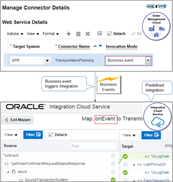

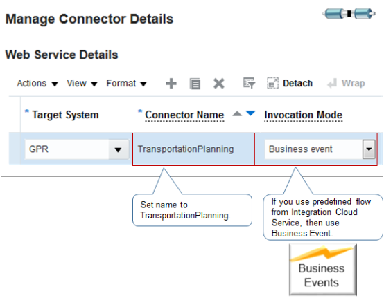

Set Up Connector
Set up a connector on the Manage Connector Details page.
Note
Attribute |
Description |
Connector Name |
Name the connector TransportationPlanning. Order Management uses this name at various locations in the flow. Using TransportationPlanning will help you identify the connector involved in the flow that you're setting up or during troubleshooting. |
Invocation Mode |
If you.
User Name |
Make sure you have the DOO_MANAGE_WEB_SERVICE_INTERFACE_TO_TRANSPORTATION_DATA_FOR_SALES_ORDER_PRIV privilege. For details about how to set up privileges, see Security Reference for Order Management. |

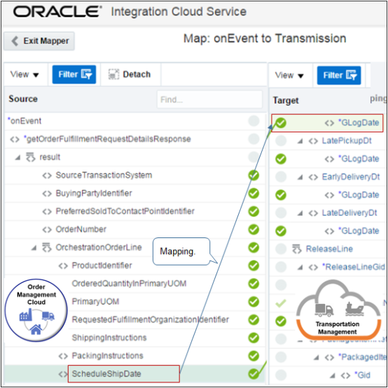

Use Predefined Integration in Integration Cloud Service
Use a predefined integration in Integration Cloud Service as a starting point for your integration. Use the TransportationPlanning connector to connect through a business event.
For example:
Note
A business event triggers the integration.
One fulfillment line in Order Management maps to one order release plus one order release line in Transportation Management. For example, the integration maps the ScheduleShipDate attribute in Order Management to the GLogDate attribute in Transportation Management.
Modify the predefined integration to meet your business requirements. For example, to group fulfillment lines in a shipment set or configured item, group them into a single order release in Transportation Management.
Transportation Management sends a status update to Order Management for each order release line that maps to one fulfillment line.
Examine predefined integrations that use Integration Cloud Service.
Go to Oracle Logistics Cloud to Oracle Fusion Cloud SCM Integration and read the content.
Click Get App to access Integration with OTM or GTM using ICS (Doc ID 2209248.1).
Import one of the example integrations into Integration Cloud Service. For example, import integration OTM_OM, Communicate Order Shipping Information to Order Management.
Examine the integration in the Integration Cloud Service user interface.

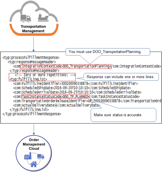

Example Response Payload
Here's an example of the response that Transportation Management sends to Order Management.
Note
The predefined integration in Integration Cloud Service uses this structure. If you modify it, then use this payload as an example of the data that your fulfillment system must send.
The response can include one or more fulfillment lines.
The IntegrationContextCode attribute must equal the DOO_TransportationPlanning task type.
Make sure the TaskInstanceStatusCode attribute contains a value that accurately reflects the status, such as DOO_TP_PLANNED. For details about the statuses that you can use, see Integrate Order Management with Transportation Management.
The screen print truncates the TransportationOrderReleaseIdentifier line. Here's the full line.
<com:TransportationOrderReleaseIdentifier>OR_300100090338878</com:TransportationOrderReleaseIdentifier>
