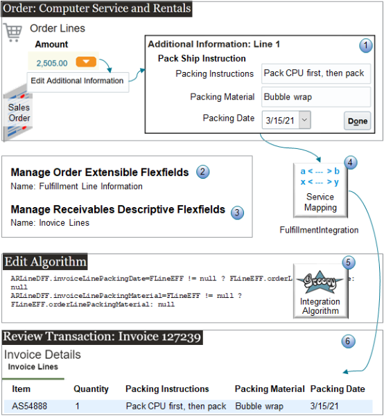

  1. Assume you need to add your own shipping details when you create an order line for a new sales order in Order Management. The Order Entry Specialist clicks the down arrow in the Amount column on the order line, clicks Edit Additional Information, then uses it to add the details.
    • Packing instructions
    • Packing material
    • Packing date
  2. You will add these attributes to the Fulfillment Line Information extensible flexfield.
  3. You edit the Invoice Lines descriptive flexfield so you can display shipping details on the invoice line.
  4. You modify the FulfillmentIntegration service mapping to map the extensible flexfield between Order Management and the descriptive flexfield in Accounts Receivable.
  5. You create an integration algorithm that specifies the data to communicate.
  6. You use the Billing work area to examine the invoice that contains the shipping details.
Summary of the Setup
  1. Prepare your setup.
  2. Edit extensible flexfield.
  3. Edit service mapping for extensible flexfield.
  4. Edit descriptive flexfield.
  5. Edit service mapping for descriptive flexfield.
  6. Create integration algorithm.
  7. Test your set up.

Edit Service Mapping for Descriptive Flexfield
Edit the service mapping so Oracle Receivables can receive the attribute details that Order Management sends.

  13. Add your integration algorithm to the service mapping.
    • In the Pricing Administration work area, click Tasks, then, under Order Management Configuration, click Manage Service Mappings.
    • On the Manage Service Mappings page, in the Name column, click FulfillmentIntegration.
    • On the Edit Service Mapping page, click Services.
    • In the Services list, modify the row that contains the InvoiceService service.
      Service
      Implementation Type
      Implementation
      InvoiceService
      Algorithm
      Integrate_OM_and_AR Custom
      This the name of the integration algorithm that you just created.
    • Click Save and Close.
Test Your Setup
  1. Create a sales order.
    • Go to the Order Management work area and create a sales order.
      Attribute
      Value
      Customer
      Computer Service and Rentals
    • Add an order line and set the values on the line.
      Attribute
      Value
      Item
      AS54888
      Quantity
      1
    • Click the down arrow on the order line, then click View Additional Information.
    • In the Additional Information dialog that displays, click Ship Instructions, then verify that the Ship Instructions area contains your Packing Material and Packing Date flexfield attributes.
    • Add some test values in your flexfield attributes, then click Done.
      Attribute
      Value
      Packing Instructions
      Test value for packing instructions.
      Packing Material
      Test value for packing material.
      Packing Date
      Test value for packing date.
    • Click Submit.
      Assume your order number is 55748.
  2. Verify that Order Management correctly sends your data to Accounts Receivable.
    • Make sure you have the privileges that you need to manage Accounts Receivable. For details, see Privileges That You Need to Implement Order Management.
    • Go to the Billing work area, then click Tasks > Manage Transactions.
      For details, go to Using Receivables Credit to Cash, then search for Requirements for Completing a Receivables Transaction.
    • On the Manage Transactions page, search for the transaction.
      Attribute
      Value
      Business Unit
      Vision Operations
      Transaction Source
      Distributed Order Orchestration
      Reference
      55748
    • On the Review Transaction page, in the Invoice Details area, verify that the invoice contains attributes and attribute values for packing instructions, packing material, and packing date.
